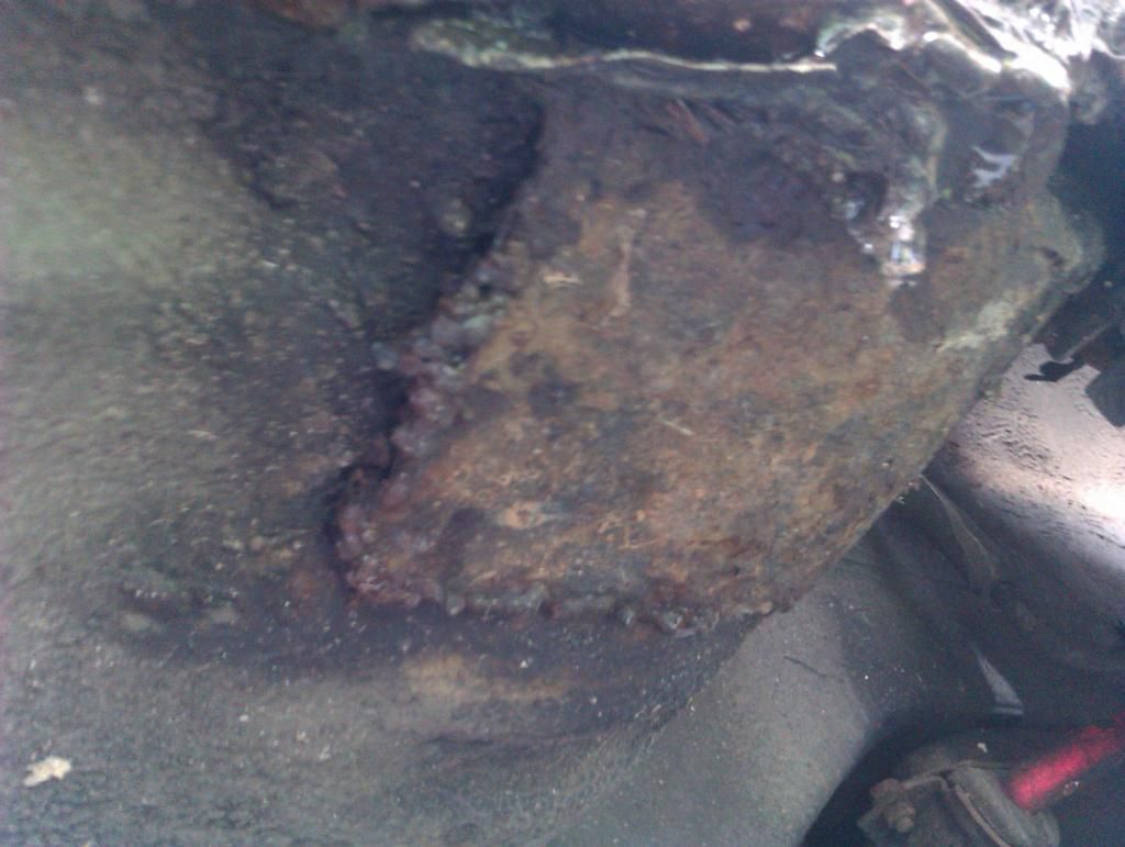

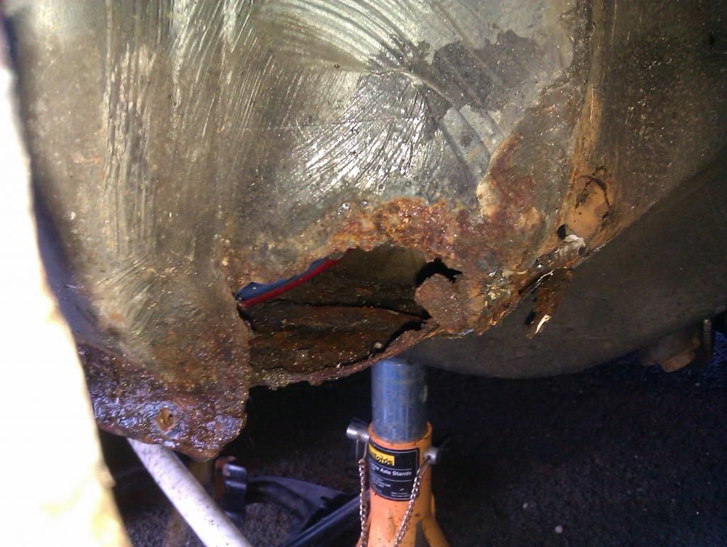

Green
Posts: 1698
Location: Santa Pod
Fri Dec 21, 2012 6:28 am
Just so you know sometimes it can look a lot better then it is, this looked fairly bad
which led to this
I had to cut this far back!
Probs took me about 8 hours to get it cut, cleaned up, a new bit shaped, welded and protected start to finish.
