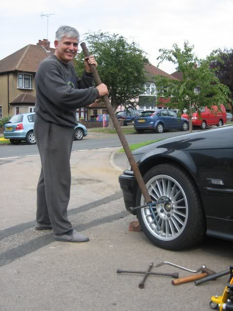

A real gripe of mine are garages who use an airgun to tighten wheel bolts. 2 second job for them, absolute bugger to sort out afterwards.
Luckily we have the 'ghetto pole' for such situations!

I assume the ghetto pole is the long breaker bar and not the guy holding it?

George wrote:A real gripe of mine are garages who use an airgun to tighten wheel bolts. 2 second job for them, absolute bugger to sort out afterwards.
I had to do the same, with my new touring when I first took the wheels off.. I'm guessing the man is your Dad.. My ghetto pole didn't come with a Dad. At the most he'd hang out the window and hurl abuse at me, telling me to leave the thing alone..
