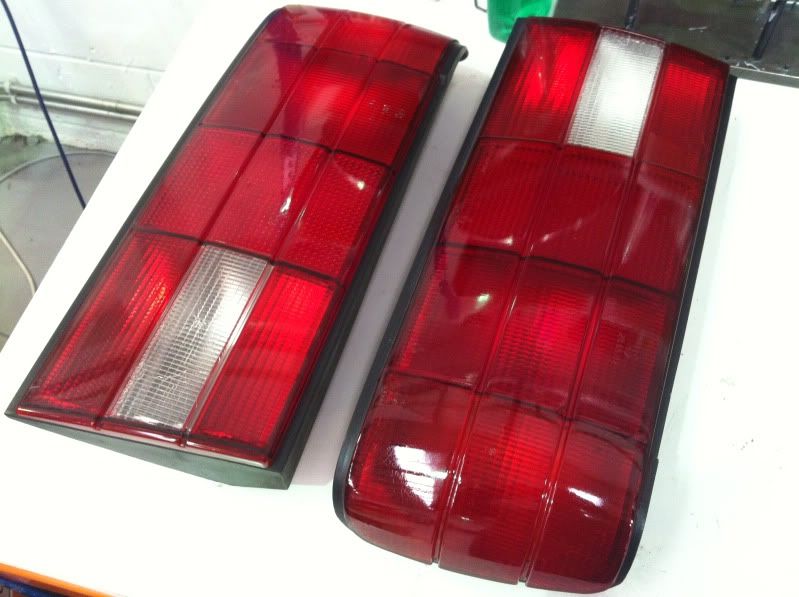

matt86 wrote: Or do you think I should give it a go myself if I have 2 pairs of standard lights?
^ this! it's how you learn to do anything on the car! nice thin coats, clean the lights off really well and do it somewhere nice and warm and dry..
there's my effort (I masked off the bit with the reverse light in it.. I think it looks a bit blocky if you do the whole thing.. I like the OEM+ look! plus.. pink reverse lights = no.. )

Yes fair play tom, they look like they've been done professionally and a very deep shine to them with no dull bits, you're clearly quite patient. :thumb:

E30-Addict wrote:+1 How to Tom please
I just cleaned them off with fairy liquid, gave them a good rinse and put them on a radiator till they were dry (really give them a scrub, any silicone or back to black or polish will make the finish crappo! )
then used the E-tech red spray from Ebay after masking the lights with masking tape over the reverse light and the reflector above and below... then I gave the can a bloody good shake and sprayed a light-ish coat on fairly fast, gave it 15 minutes to dry tacky (don't touch it) and put another one on.. making sure I got all the curves and running it over the edge... left it to dry for a couple of hours and whacked it back on the car.. (I have a low temp oven at work that is ideal for this!) took no time at all! also mask the tiny black plastic edge too.. it's attention to detail like that that makes the difference :)

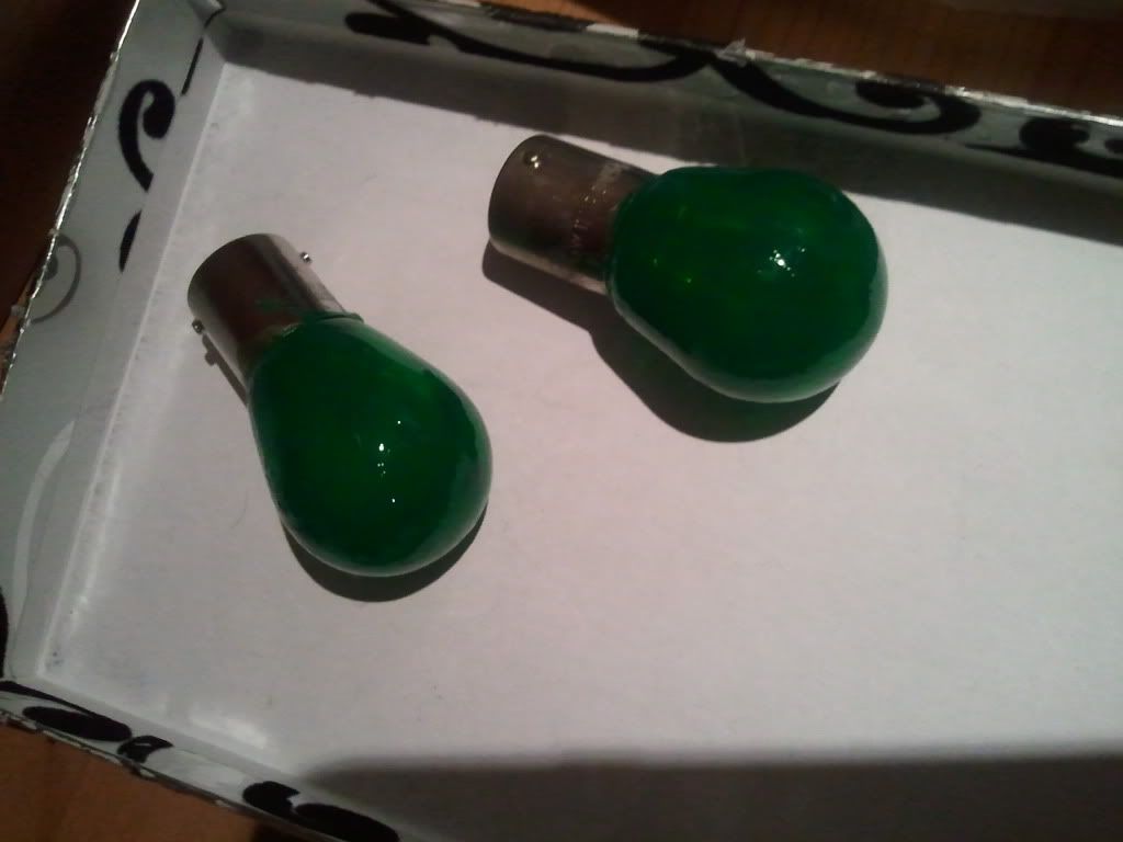

Hi I have done by lights tonight and there looking really good, just want to get a good shine to them now, how many coats of laquer are recommended 2-3 lights coats?
Also has everyone thats fitted this painted the indicator bulbs green?
Or can you get away with it without? also has anyone ever been pulled with the lights like this?
Cheers :D

I have never been pulled look at the link I put up theres a pic of mine jus as they flash look orangey , that is with painted green bulbs, when you use lacquer, lacquer them alot so the light flashes bright if you dont they indicate very dim. I used green glass paint tried the nail varnish didnt do alot, most arts and craft shops will stock this.

I didn't use any lacquer! :? you shouldn't need it!
also, lacquer will not affect the transparency of the lense.. just so you know..
