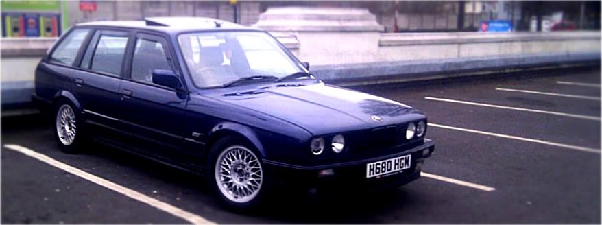

I'm new to e30's so don't know much about ride heights. My touring is said to have schnitzer springs on but I'm trying to work out if it is standard or not. And if it has by roughly what amount?
Then I can get some idea of how low I'm going to go. I'll be running 15' BBS with 45 profile tires when it's done. but as I'm going for shocks and springs rather than coil-overs (which I'm used to) I need to get it right. I've seen 40mm 60/40mm and 50mm and from what I've read on here 60mm all-round is too low for daily and as I'm in the process of fixing a cracked sump I'd tend to agree with that!
I know with 15's and 45 profile I'm not going to get close to the arches but I don't mind as long as it looks and drives well.

That looks like it has been lowered to me, by about the correct amount.
If you want it to look and drive well then stay with 55 profile tyres, or 50 if you don't mind an arch gap.
This is on Eibach Pro kit springs (35mm approx) with 205/55/15 tyres
it DOES scrub the rears in about 10-15k miles. The inside of the tread goes before the outside looks half worn. Camber correction is the only cure.

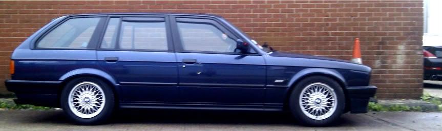

Thu Jan 26, 2012 6:07 pm
mine is lowered 30mm on apex springs no issues

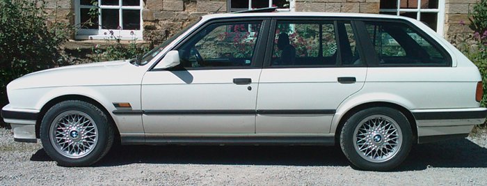

Only done about 4500 miles on these wheels & tyres, but before I changed all my bushes, I was running 17's that would eat the inner side of tyres.

oomz1975 wrote:Only done about 4500 miles on these wheels & tyres, but before I changed all my bushes, I was running 17's that would eat the inner side of tyres.
Have you got any clearer pics of your tourer??

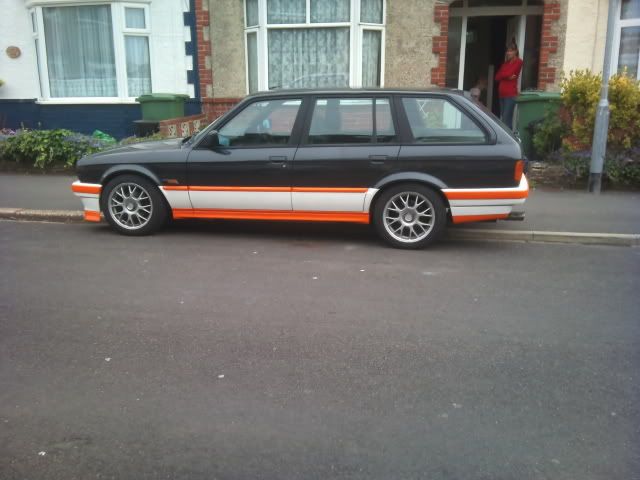

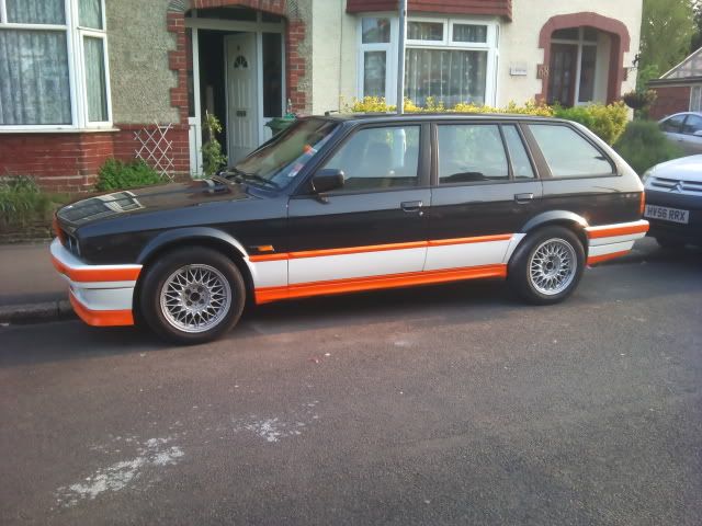

Phill172
Posts: 1117
Location: Basingstoke
Fri Jan 27, 2012 4:56 pm
Cheers.
Excuse my gay offset wheels but to give you an idea of the amount of camber that can happen. The fronts have 8.5d of camber...
This is on HSD coilovers, not horrifically low as I had raised the ride height but this kills tyres on the road, its got brand new bushes all round.
I doubt id get 4500 miles
I need the camber correction kit badly
Saying that I also find with lowered e30s they always look saggy at the back, the white on on eibachs above looks spot on mind
oomz1975
Posts: 2019
Location: London UK
Fri Jan 27, 2012 6:15 pm
Hope this helps...

Cheers oomz, now I can see that you are running standard ish tyre profiles . The pic of your car in the shadow makes it look on the deck, but 60mm is not looking too bad now. winkeye
I think I'll be needing new top mounts and some bushes.

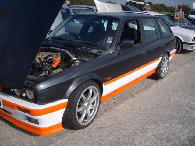

Cotty
Hartge Crew
Posts: 5926
Location: Orpington, Kent
Wed Feb 01, 2012 11:11 pm
savagehenry wrote: Interesting.......I was thinking IS spoiler too.
IS lip and 60mm drop. Don't try bumping up any curbs

Great pic. I'm just in love with that IS look. Are you running -60 on the front on the pics below??
looks higher.
Cotty
Hartge Crew
Posts: 5926
Tue Feb 07, 2012 9:11 pm
-60 on the front, -40 on the rear. KW kit
Also have H&R ajustable antiroll bars but the front one is temorarrily removed as it fouls on the wheels. I have a second set of wheels in the garage with differnt offsets that would cure the problem but they need a refurb.
I won't mention the full Hartge body kit in the loft ..... DOH

hongkongfuey
Mad-tango-geezer
Posts: 3304
Wed Feb 08, 2012 10:44 am
here are a few of mine, mine is dropped by 30mm apex springs
these on 17" wheels
16"
15"
with cars like mine,
