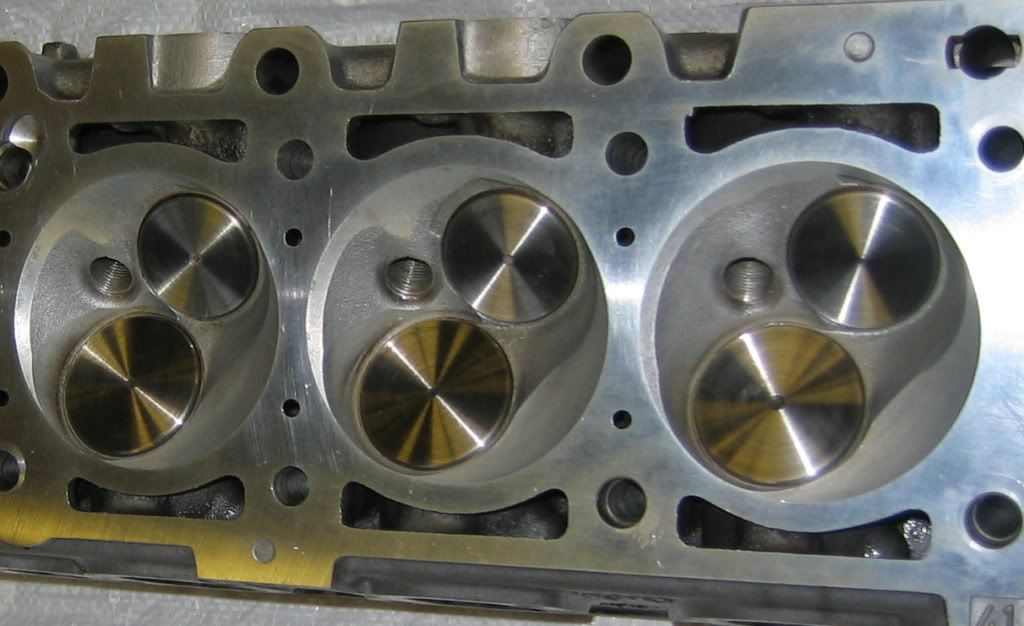

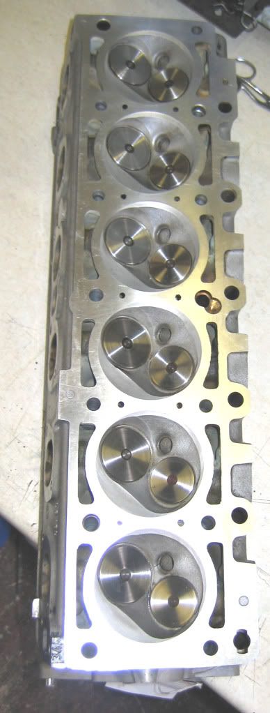

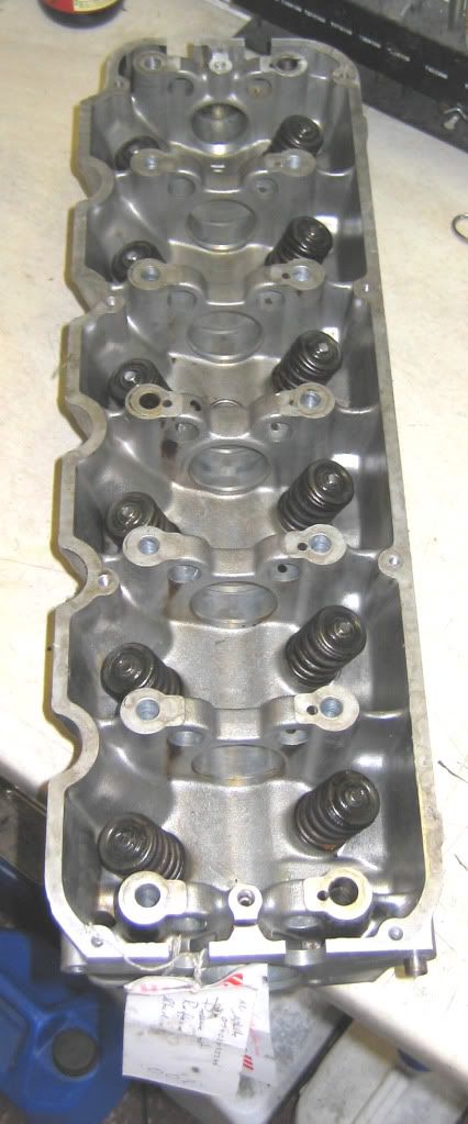

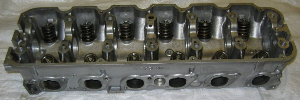

I have one here, pressure tested, skimmed by only 0.002" with a reciept for the work dated a month ago. All threads are good. Never been fitted, no Cam or followers inc. £275 collection from Near gatwick. It's the umpteenth one I've done with zero complaints so far. Can ship at owners expense to within the UK.
I'll partex your head as long as it's never had any over heating issues and the galleries are good.

Here is a couple of shots of my head to show what £275 buys you:
