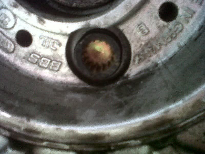

As above any suggestions :(
i need them off, i would try smashing a socket on them but it wont work as there round with the pattern inside :cry:

IIFC 19mm impact is the wepon of choice mate.
Although they are round it should still work. You will need a big hammer, if you get stuck bring it over, i will sort it for you for a couple of bears :wink:

easy just take the car to the dealer, they keep 1 f every key made!!! short of that a semi blunt chizzel and a big hammer works every time especially if you've done them up far to tight!!!

Weld a nut on it, or get ATS to, that another suggestion that actually works (from experience)

Smash a normal wheel bolt into the locking wheel nut and then mig them together. Job jobbed.

I am pretty sure its a 19mm you want. Sledge hammer is required. It wont want to fit over, it will though winkeye

No, a vice would help though.
Otherwise wind the locking nut back in by hand, Work the socket up and down and side to side with an extention.
Big hammer FTW

they are later bmw nuts m8,you only need a small handled mash hammer really

Dezzys right 19mm socket and whack.
Sun Mar 27, 2011 10:59 pm
half inch extension bar works on these, just smash it in and stick a ratchet on it :D

I have a spark plug size socket with loads of pins in it.When you put it on the nut the pins go to the shape of the nut.Cant remember where I got it from but it works.(may have been halfrauds)

Normally a good chisel straight in and a stilson to turn out

I have either tack welded another bolt on a undone it that way or just drilled them out, need a good drill and diamond cut titamium coated drill bit, goes straight through them no worries, just have to be carefull not to damage the thread in the process.

Half inch extension bar.

Another vote for welding, Use a bolt rather than a nut as you have more surface area to penetrate - Use maximium power also.

A Gator Grip Socket is another option
