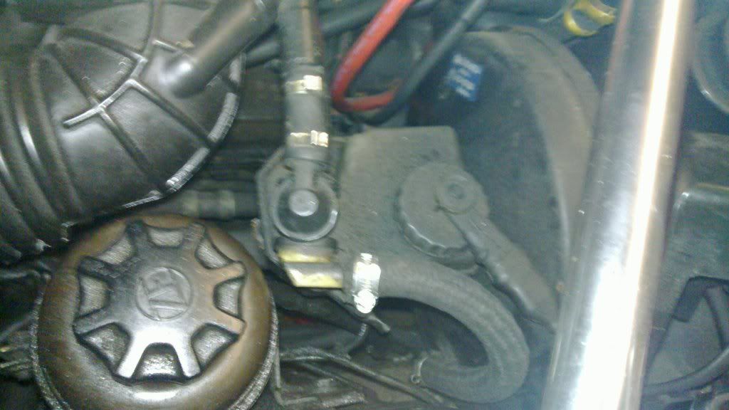

I'll go grab a pic for you but its the little resivoir with a yellow screw cap, will have wires attached to it.
318i Touring
TouringTash
- Posts: 3804
- Joined: Mon Jun 28, 2010 11:00 pm
- Location: Kent
Thu Feb 10, 2011 5:55 pm
No its not yellow its the same colour as the reservoir
Not the cap with ZF on it as thats for the power steering
