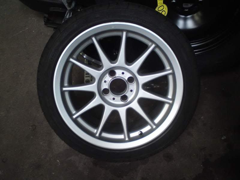

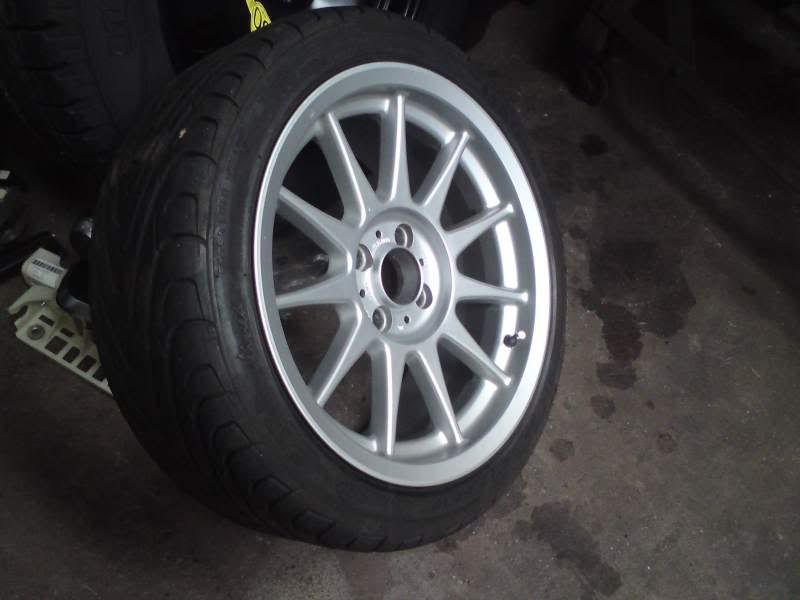

Hi guys, I've spoke to one or two members on here about using the above tyre size and apparently I'll only get away with it on the rear?
Situation is: When i bought my cab it came with some horrid cheap 15" 5 spoke jobs that i want to get rid of. A friend of mine is into his mk2 golfs, I've seen quite a lot of pics of them with Azev A's and i think they look awesome so I got myself a set.
But they are 16"x7.5", which means to fit 205/50/16 tyres on i'd have to have a bit of stretch, i've seen 205's fitted to 7.5j before and do not like the look, its not a proper stretch (which i dont like anyway) and they dont look 'normal'. Also this size obviously offers zero rim protection, which is something that is quite important to me since I wont be the only one using the car so i'd like my Azevs to stay kerb free.
So to keep the Diameter the same the next size up is 225/45/16, this will also offer some rim protection. I understand on the rear it wont rub but the front it will. I take it it would rub on the inner arch? in which case some spacers would fix it?
Also if i was to lower the car (intending on 40mm atm but wont know for sure until i fit the azevs (but I cant fit them until i get tyres and i cant get tyres until i know which size i want) would this mean i was more likely to get rubbing? how about 60mm?
they are et20.
I dont want to get my arches rolled or do negative camber (they're only 7.5j!) so if i cant fit 225's im gonna get rid of the azevs and probably get some oem bbs.
What do you think?

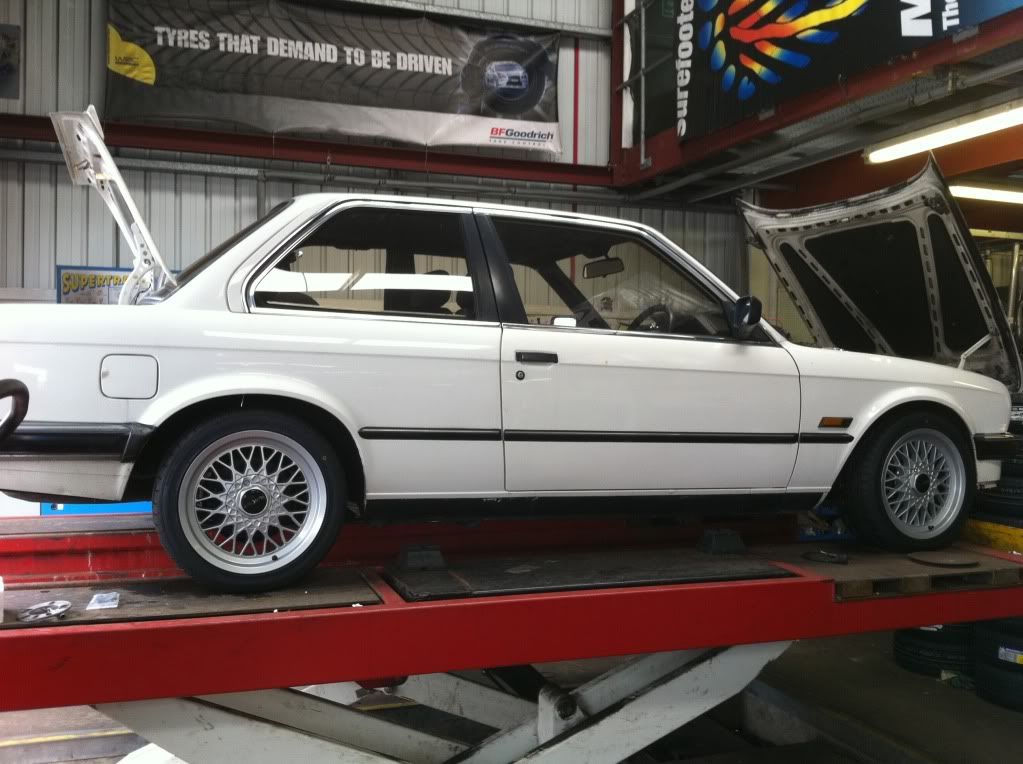

i have 225/50/15 - et35 compomotive ml's with falken ze912's and a 10mm spacer (making it up to et25) for those 16's you are going to have to machine a bit off the inside to take them to a 25 or so, do your measurements right and they will be great on the back!
mine is lowered 60 mm, see below - no arch scrubbing, and a neat fit!
71780_161031150581179_100000228864526_421323_4059230_n by clarkyboySE, on Flickr
71780_161031150581179_100000228864526_421323_4059230_n by clarkyboySE, on FlickrDan your car looks looks far too nice in them pics. My car has exactly the same suspension set up as Dans but my wheels are running et20 7.5j 16"
