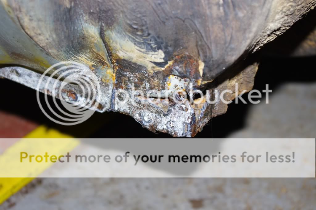

I found both of my front jacking points looking like this when I removed the front wings;
What is the most common procedure for repairing this ?
Thank you
will it not be visible that the whole jacking point is gone ?nickso wrote:remove the "jacking point" completely, its only 3-4 spot welds. that leaves a nice area to work with when covering up the holes.
you might only have the hole in the side of the well to deal with. you might get away with a clean up of the floor. only way to find out is to remove the non jacking point.
