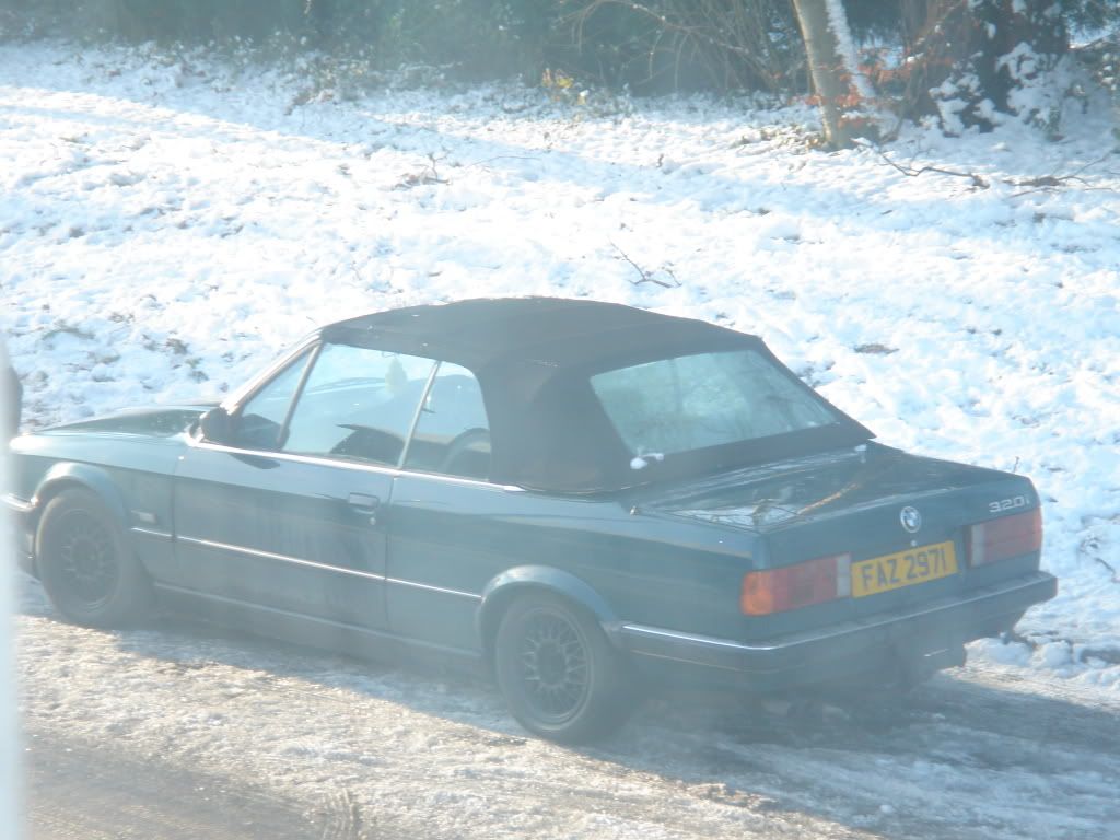

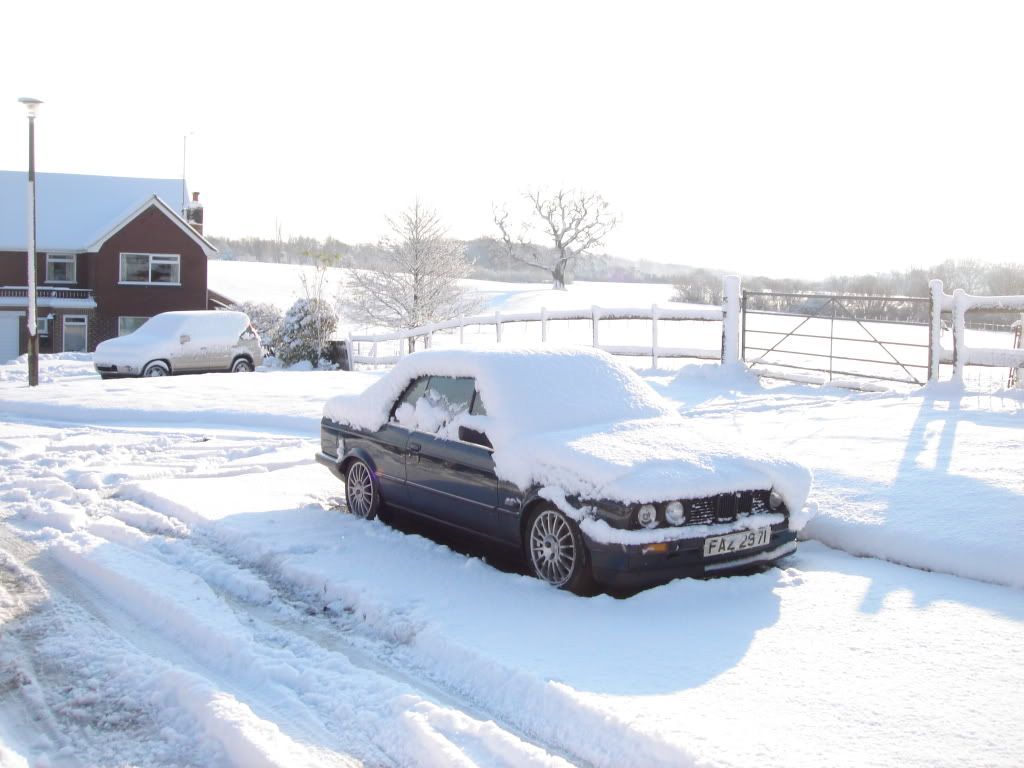

nothing recent, back in the snow,
am running bbs, with 185/60 tyres, i did run 16s but was constantly buckling wheels with 45 profile tyres!
sorry for the shocking quility, it was taken through a dirty window, will get some pics tomorrow
hers some on 16s
