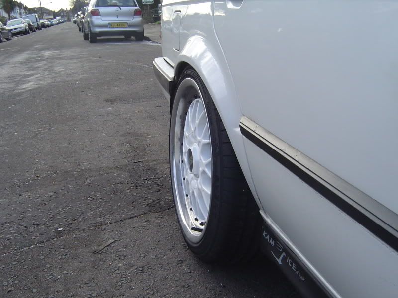

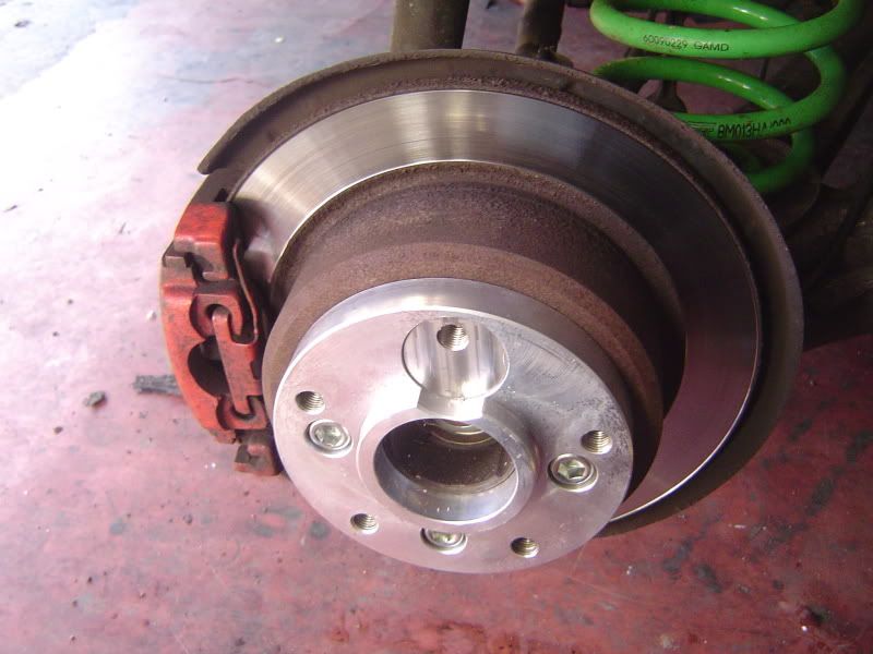

Well here are the awaited pics i will post some more when i detail the car properly.....

Whta you guys think?????

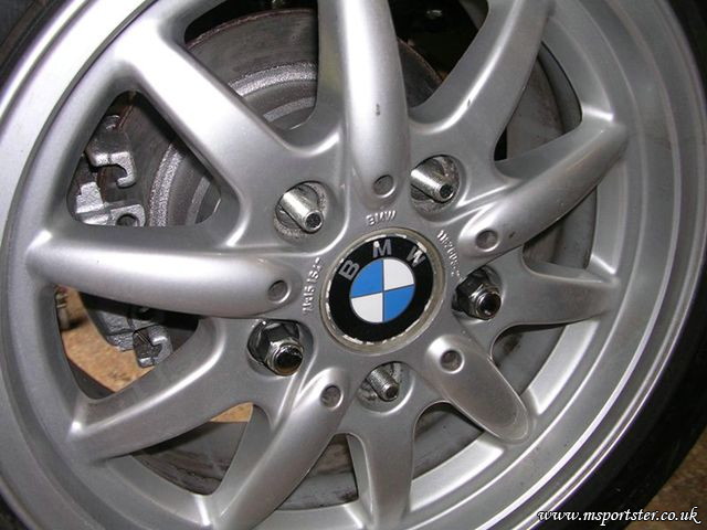

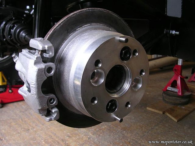

yeah they do. I have got a set in the garage I'm not using:

dame they look good, but surelly the £70 will do the same job with out the £300 price tag
love them wheels, what were they again.
think i`ll get some of them.

Cheers baz, as i said before the cheaper adaptors they dont do it in this fitment hence custom made hence the price tag!!! the rims are the e36 328i sport rims RC041 fronts and rc042 rears.

I bought mine off a zoner (via ebay) several years ago for about 185 I think. Well engineered adapters. Ended up using 4 stud wheels on the car though.

those wheels do look very nice on there. funnily enough they're the same wheels i was thinking of fitting to mine, hence looking at making stud adaptors.
a question though, what's the score with the 4th 4x100 bolt? what's that insert? does it screw in or something?
looks iffy to me...

yeah it screws in, because if you calculate the 4x100 over the 5x120 one bolt overlaps thats why you need one thats like a shim insert. Its been tried and tested.
