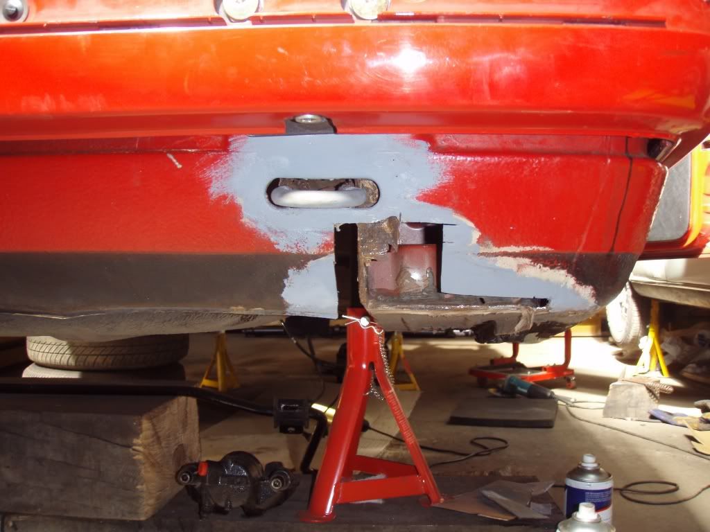

would this be a problem too
hole is twice as big but has sharp edges so.... :? hopefully this will be finnished by then :)

Look at the state of the bottom of that sill! :nono: winkeye
Think you may get advisories on the bushes and pipes, But not on the valance rust!

Thu Jul 23, 2009 10:43 pm
Even my chrome turd doesn't have rust thtat bad on the valance! :eek:
ANd white sills :puke:
Thu Jul 23, 2009 10:45 pm
you relise ive cut it out, it was a small patch when i started but there is always more rust than what the eye can see, its twice the size of that now :wink:

Rub the pipes down with a bit of wire wool and then grease em up. Don't think the rear valance is a fail but I couldn't live with it and I'd be amazed if you can Alex!

Sharp body work fail. Play in anti roll bar bush fail. Think that's a breather so should be ok. Stick some underseal on and cross your fingers. If the bush isn't too bad and isn't knocking you might get awY with that but they are pennys I would advise you just bang one on.

Mine failed on a hole smaller than that in the same place last year.

what a shed :) :D only messing - i would just sand down the brake lines - change bushes and remove sharp edges from back panel.... :cool:

pipe is a breather pipe though, drop links don't normally fail just the roll bar mounting bushes. The jaws impersonation will fail though!

Fri Jul 24, 2009 12:55 am
Simon13 wrote:pipe is a breather pipe though, drop links don't normally fail just the roll bar mounting bushes. The jaws impersonation will fail though!
:lol: hopefully it will be done :mad: fell a bit daft driving around with it cut out, but i need the car
its a square with a smaller square above it now winkeye

I think you can just cover up sharp edges with gaffa tape for MoT purposes - it's purely a safety issue, whether it will mangle someone just by going near it, so some careful covering up is all that's required if you can't repair before MoT time.

Put gaffer tape over the rusty bit you cut out if you don't get it done in time. My mate's Transit had literally no arches left, so he gaffered them.

As for the corrosion on the lip. Is it within 30cm of any steering suspension brake or seat belt mounting? If not then will it affect the steering or braking of the vehicle.
As a sharp edge it must be likely to be caught by a pedestrian. I would suspect that if any pedestrian as injured by that then they would have other injuries to worry about as you would have knocked them down to begin with winkeye winkeye

Well ive just been to MOT garage to get it booked in, i mentioned the rear valance and he had a look, he told me not to worry about it as its low down at the back, its if its further up the car it would fail

It has been welded up (not as straight forward as I thought) and i'm going to paint it this evening.

is there any chance you could explain how you welded yours???
did you put a plate inside from the boot then one on the outside
i'am trying to get an almost original finnish to mine and i can see it needing around 3-4 different plates putting in, some really small :mad:
