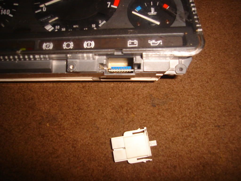

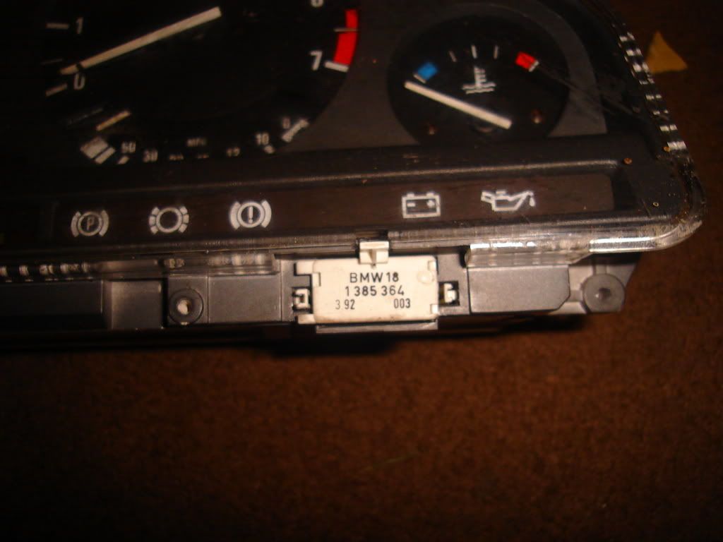

hang on i have a spare instrunent cluster, ill take and upload some pics just for you....... :roll:
the white bit is the bit, put a 4 pot one in a six pot or vica versa and the rev counter will be out as the dash pod is "seeing" 2 more or less cylinders than it "knows/thinks" it has.
