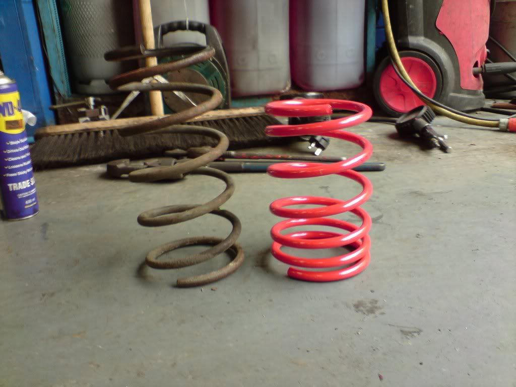

the springs

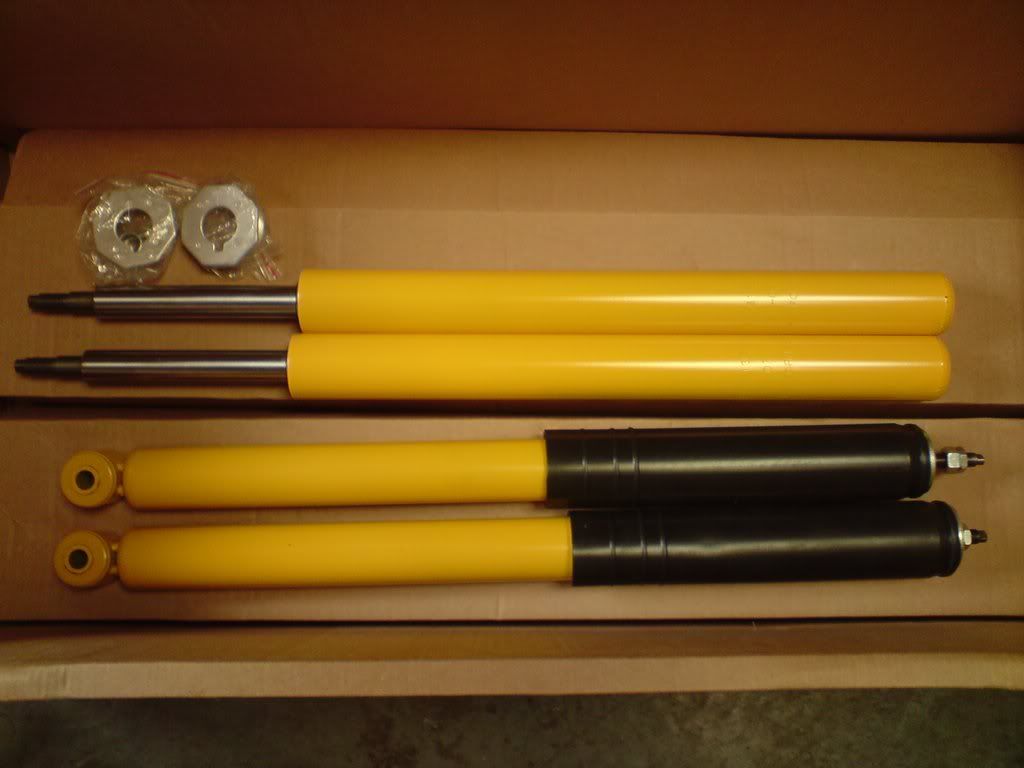

the shocks
spring difference

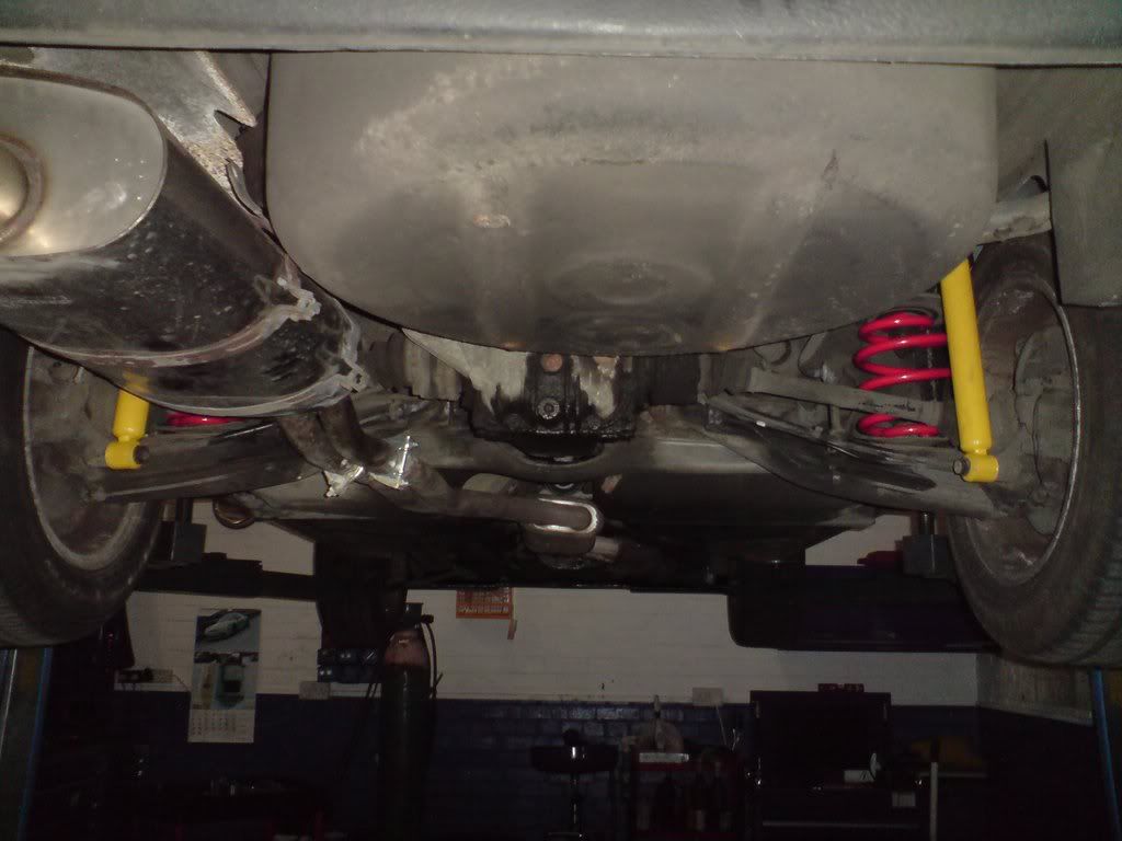

all fitted

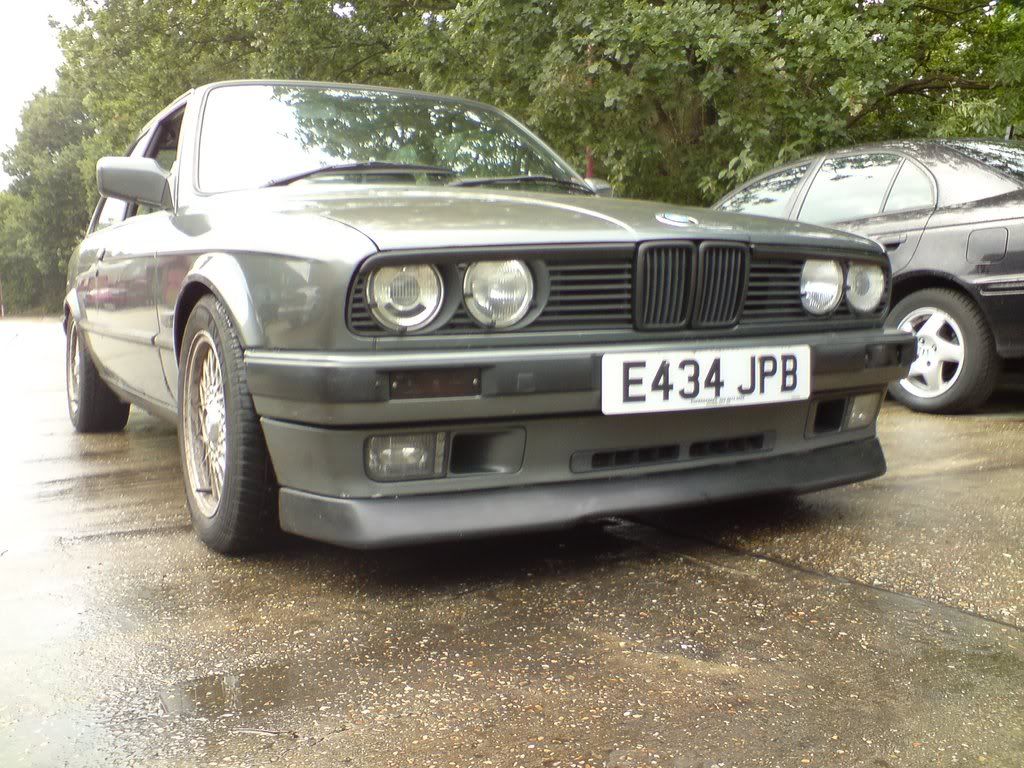

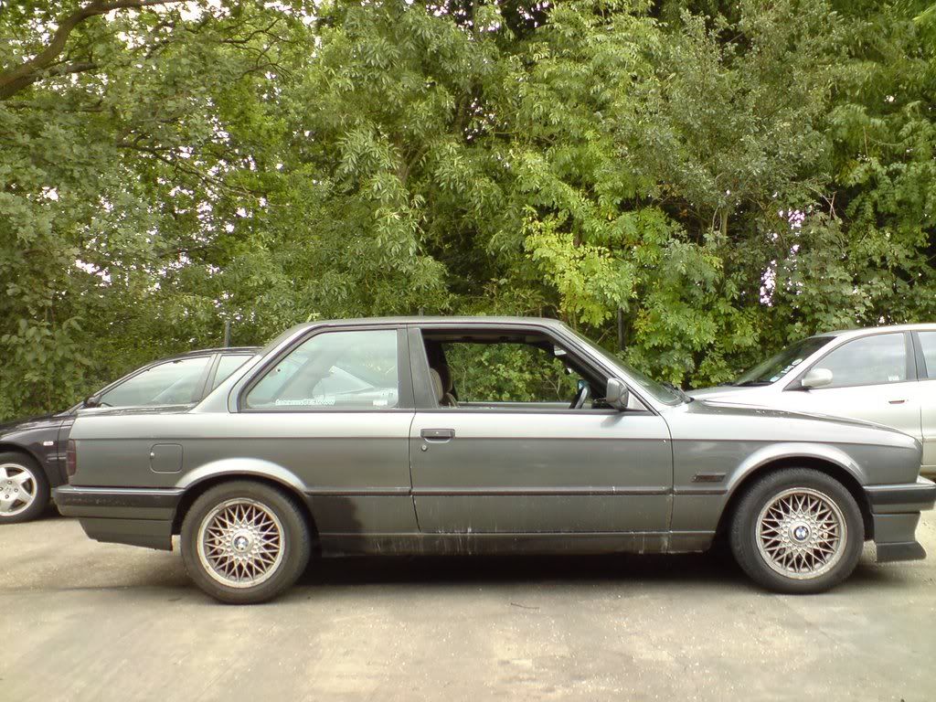

the before shot
the after shot, need to settle, this was taken 2 minutes after fitting
after shot 2

A -60mm kit that didn't lower at all!! Are you sure you haven't used the same pic twice?!

Jhonno wrote::lol:
already edited matey :D :wink:
Tue Sep 09, 2008 6:47 pm
:lol:
Have to say, not keen on how that sits.. Has it settled any differently now?

Jhonno wrote::lol:
i totally agree mate, thankfully the front has dropped about an inch.
