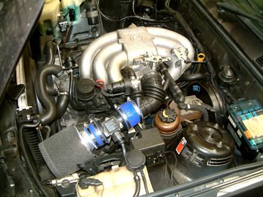

MONSPORT42
Posts: 506
Location: Portsmouth
Thu Jun 16, 2005 11:33 pm
MAF Conversion: This is the sytem used on the E36 and does away with the E30's AFM which has a electro mechanical flap which gives a comparatively slow throttle response. The MAF has no flap and relies on a wire sensor to measure air flow. It can be mated to the standard airbox with adaptors but most people use a cone filter, shieded or unshielded. The standard ECU does not however understand the signals sent out from the MAF so it requires a piggy back chip (Unichip) to convert the data. This requires a rolling road re-map. A MAF conversion will not usually give a greater max bhp (in fact mine is slightly lower than with the standard AFM) but when set up properly gives a better power curve and much, much quicker throttle response - it's virtually immediate - and therefore makes for a great drive. It helps to overcome the 'less revvy' criticism of the 2.7 conversion. Having said that, I had originally opted to fit an MBE (stand alone system like Emerald) system which in theory is even better but it wouldn't work with my autobox!
