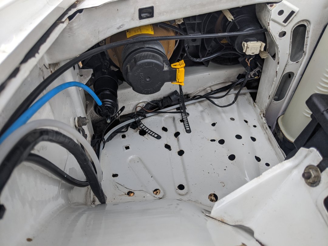

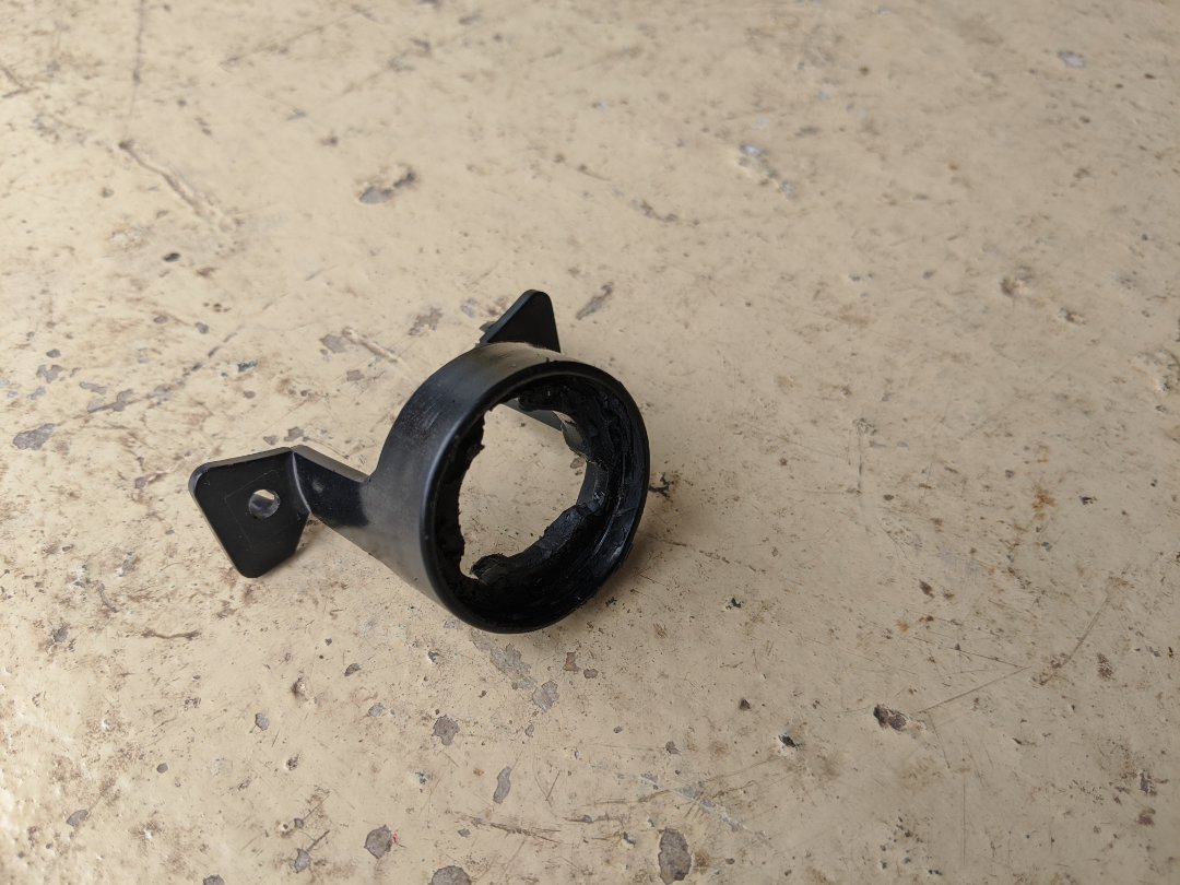

regards
Richard
You have to line up the 3 points on the light adjuster end with the slots in the back of the headlights and twist to get them to lock in.
The slots look like this. This is one of them detached from the back of the headlights.
