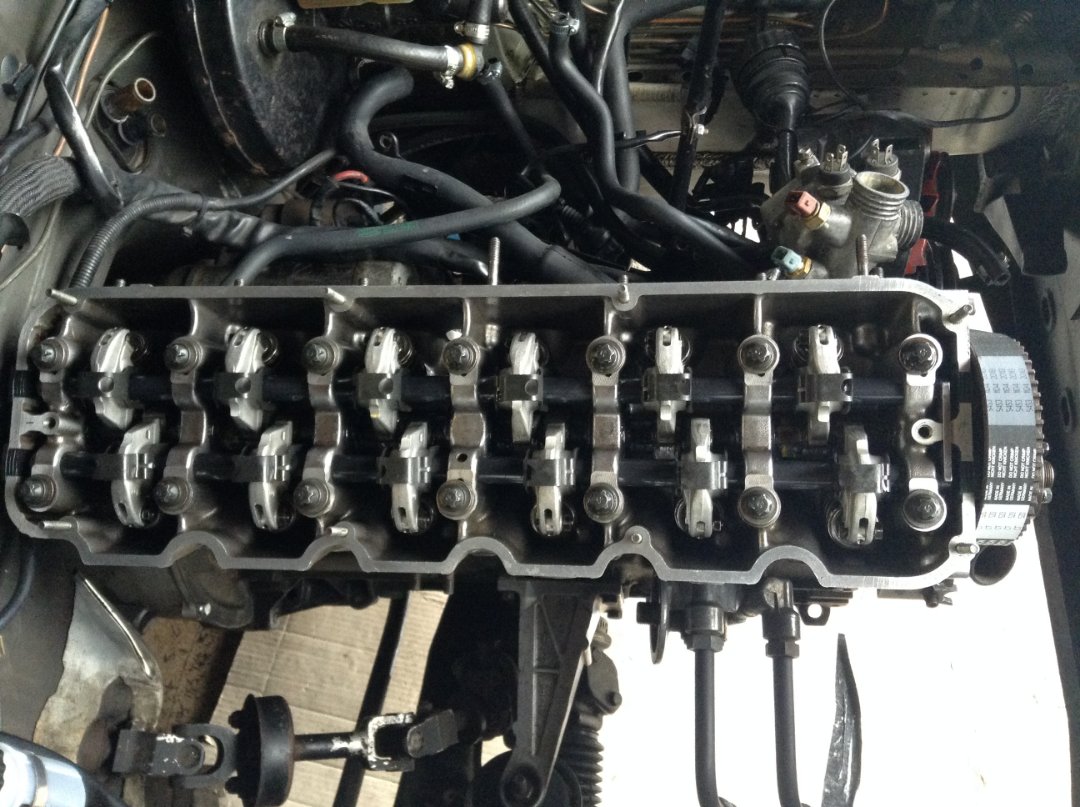

and here's the head top side --

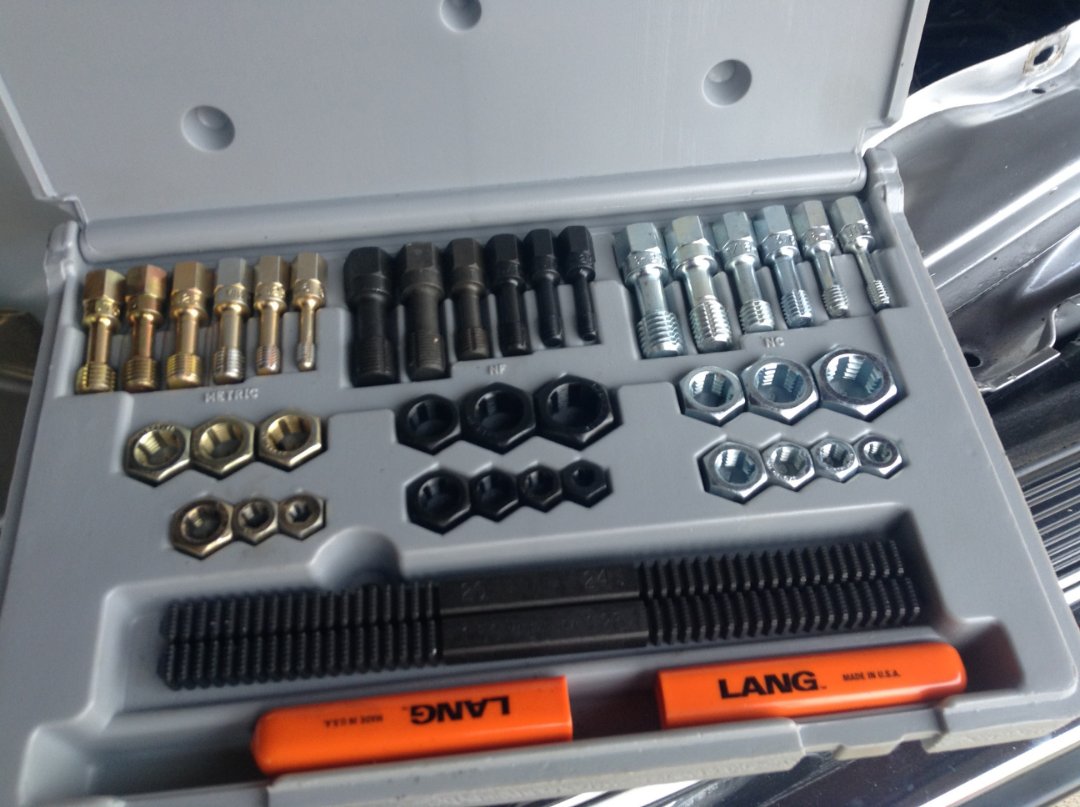

and one of the best tools I recently added to my collection, absolutely invaluable

What benefit does that have over a tap set? I just use a tap to clean out old threads.
Brianmoooore
Posts: 49360
Post Wed Jan 16, 2019 1:19 pm
Tedswagon wrote: ↑
Wed Jan 16, 2019 1:08 pm
Most of the time either can be used, but in cases where the metal of the thread has deformed in a particular place, these will tend to reshape the metal back to where it was, whereas a tap or die will tend to cut the deformed metal away as swarf.

How much did you pay for that kit and where did you get it from?

Spot on Brian, it seems like these "form " the thread as opposed to what you say as cut away material.
Metric,ok but unc and unf ??
I work in the oil and gas sector now and it is all imperial still but the car side of things are mainly metric.
Mart. :beer:

I had searched everywhere for one of these kits and found this one on Amazon US, it was about 80 euros with duty paid on Black Friday Deal.
I also bought a spark plug bore chaser, I now have clean threads as well as a cross threaded cylinder that is fine, having chased it from the valve side of the head, another brilliant piece of kit.

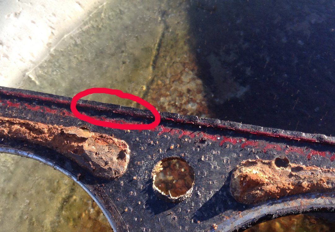

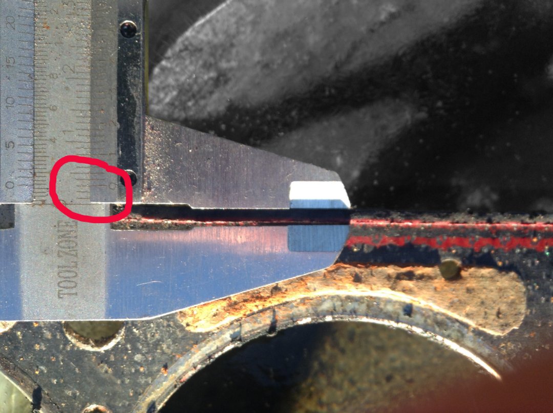

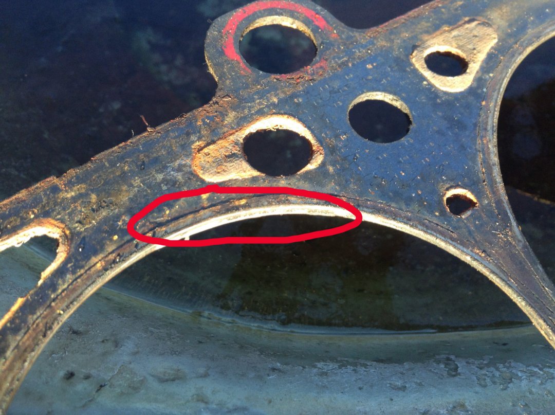

So here's the rogue old head gasket, fitted by someone with little idea how to do it, the rear location
pin was missing from the block and had allowed the rear of the gasket to sit about 4 mm off center at the back
This shows the edge of the gasket which hung out the side of the head/block
Cylinder 5 was sufficiently off center to be worn away by the piston, but hadn't broken the flame ring.
Cylinder 6 flame ring was worn away and split open causing failure
Paul :-)

At least you have the satisfaction now of knowing WHY it failed. My own introduction to the world of E30s was by courtesy of another equally clueless 'mechanic' changing a head gasket. It was a very tidy 316 saloon, whose head gasket , I presume, had failed, for reasons unknown to me, and had been replaced by someone who had manged to get most things wrong. It promptly failed again, oozing grey water/oil emulsion from everywhere possible. I acquired it for about a sixth of its value as a running car. It came with a complete spare head, but all that was required was a massive clean up and a gasket set.

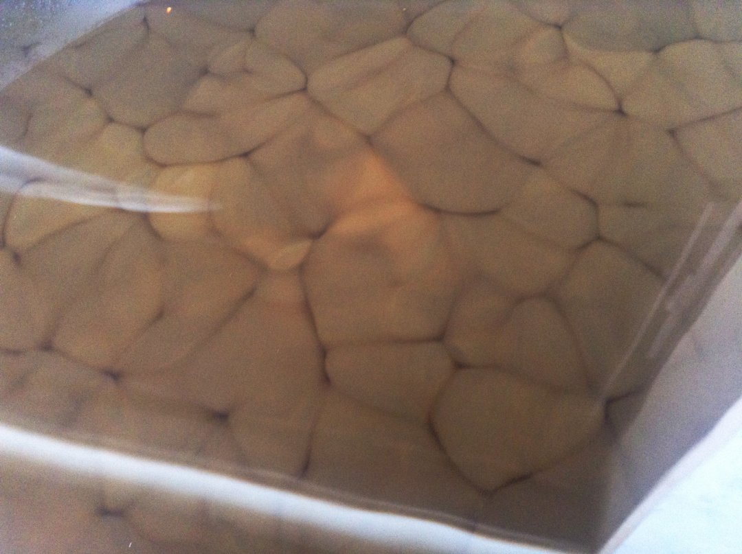

Here's what just came out of the engine after running with fresh oil and new filter for about 20 minutes!
Yuck!
Looks spooky eh? water and oil suspension....
So there's plenty of old emulsion still in the system, car is producing a lot of steam when hot, exhaust system is full of water I guess, and the
oil/ water slop will create steam in the cylinders too.
Not sure how many changes it'll need to get really cleaned out.
Paul :-)
Brianmoooore
Posts: 49360
Post Sat Jan 19, 2019 1:27 pm
Took months to completely clear from the car in my last post!
