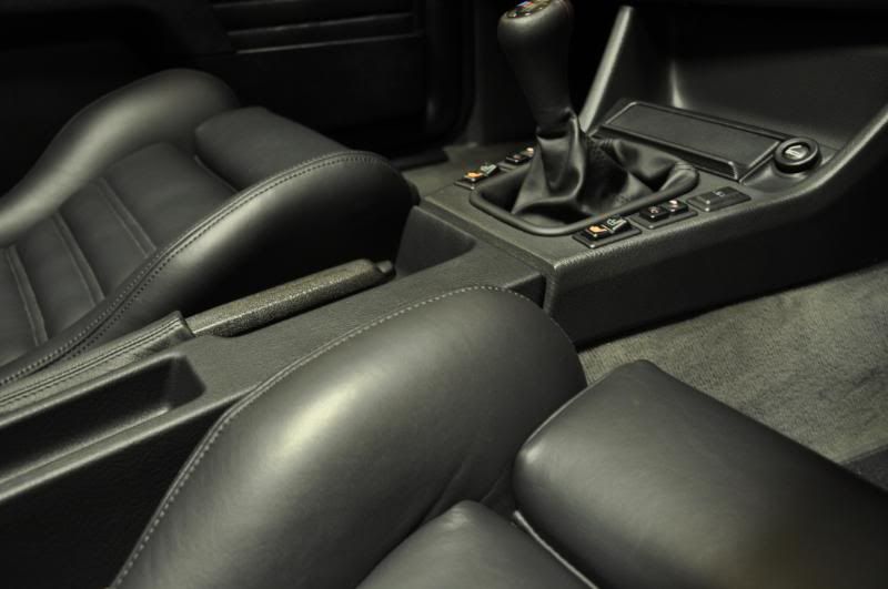

Nice leatherzz Baz

How dare you!!! These are a quality retrim
Look where the heated seat switches are

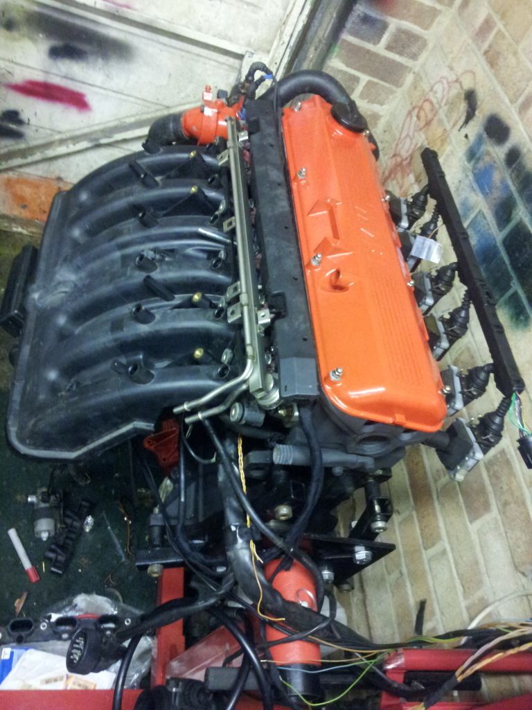

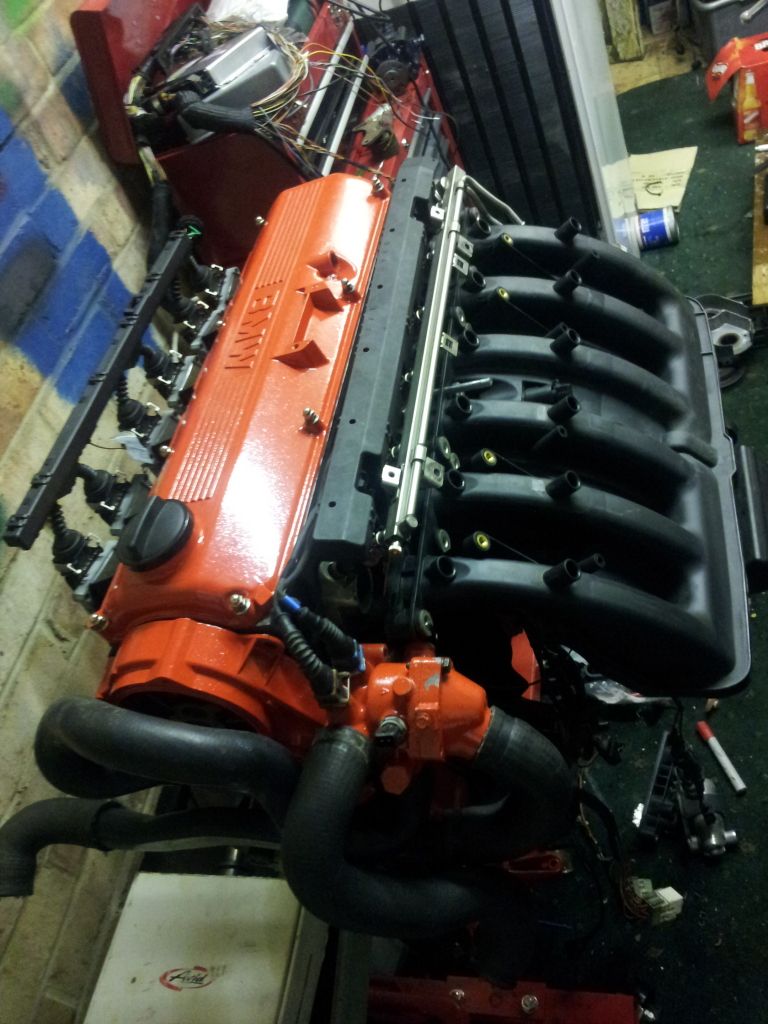

Fair to whore this here?
I'll leave you to work out whats custom.

I cant even begin to comprehend the mods youve undertaken, how you worked it out and what you did. I read your thread and my brain almost went on fire.

With you on that one! May as well be pictographs in stone for all I can make of it!!verde wrote:I cant even begin to comprehend the mods youve undertaken, how you worked it out and what you did. I read your thread and my brain almost went on fire.

Ditto man. Im getting better mechanically, but i mean thats something else. your a different level of man screech, maybe il be there one day but for now..its all fuckin pictographs

If you ever curious about anything in there or don't get it just fire me a PM.

M20 block with Coil-on-Plug ignition and M50 intake manifold (presumably for MAF and progressiveTPSensor, not switch) plus M5x injector rail and carpet-mounted ICV
If you get that baby up and running, I'll do the Wiki write-up immediately!

Icv is there while i work out which one to use.Grrrmachine wrote:M20 block with Coil-on-Plug ignition and M50 intake manifold (presumably for MAF and progressiveTPSensor, not switch) plus M5x injector rail and carpet-mounted ICV
Its not an m50 manifold.

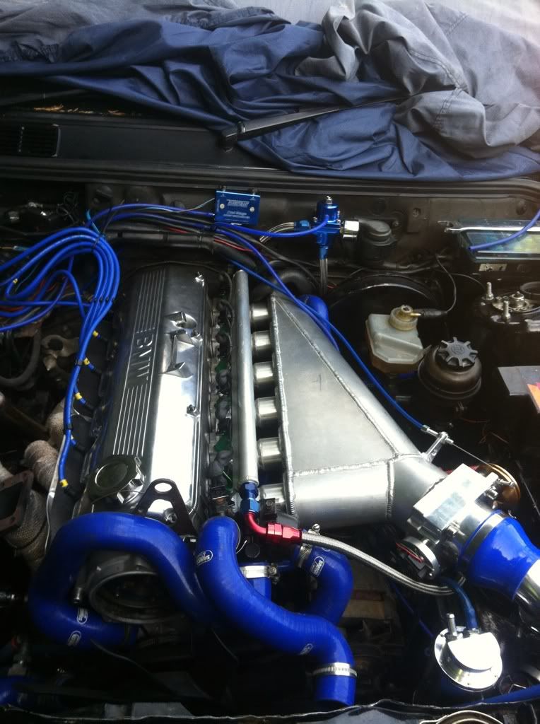

my contibution
custom inlet manifold with custom billet fuel rail
and yes i did make it my self

^ Nice. And does it work well?

not had it running yet mate will start her up tomorrow when i finish work

Well, best of luck with that, it certainly looks the business.

Sorry but that M54 manifold just looks wrong, looks like its on the engine mount its that low! The hard work will be getting a decent intake and filter in there I expectHairyScreech wrote:Fair to whore this here?

The engine is mounted vertical rather than on the cant there boss, seeing an m20 vertical does make it a bit odd.
Its quite a way off the mount and is still just something i am toying with atm, I think the bigger issues atm will be the clash with the thermostat housing/mounting flange and i need to get a starter motor lined up to check i still have room.
Soooooo many fitment issues but i want to run with it as it has real practical benefits, The DISA looks so simple but actually achieves its aim. Pretty much creates 2 long manifold 3 pots at low speed and 1 short manifold 6 pot at high speed.
Maths says its no restriction at peak and is worth 8lb/ft at peak torque.
The runners are perfect for the port sizes the m20 head want as well.
Still i will post more once i get proper time on it, however if it doesn't work then i will just have to make something from scratch i guess.
