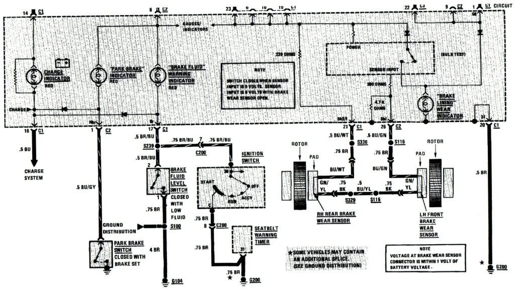

On my "new" touring brian - the connector is there but there is no sensor plugged into it - the last person to replace the pads obviusly thought it wasn't neededBrianmoooore wrote:On E30s with rear drum brakes, there is a short loop of wire connected to the plug of the fuel pump, etc. loom under the RH side of the rear seat cushion, which simulates the rear pad sensor.capri_rob wrote: on my turd There is no sensor on the back at all
dash warning light???

Thats exactly how it works on All BMW's up untill cars with CBS data (condition based serving) like the E60's E90's etc.Jhonno wrote:I thought it was a break in the circuit thing.. No grounding involved.. That is how it worked on my e36 anyway. Can't remember about the e30.
Their pad sensor wears through altering the resistance with the instument cluster working out the remaining distance left on the pads give a display counting down the miles.
I can assure you that the pad wear sensor when worn through or broken does NOT short to ground through the brake disc!
Firstly, look at the diagram above, its there in black and white!
The wire is broken and the battery voltage input is removed from the input on the instrument cluster which in turn closes the open circuit for the warning light thus putting it on!
The flickering you mention is where the two parts of the broken wire intermitantly touch untill they are worn enough to remain permanent open circuit!
Secondly, the brake disc is not dirrectly grounded to the body, its bolted to the hub which is pressed into the bearing. The resistance in the bearing is incredibly high, something like 1.2-1.5 Mega ohms! Go a take your meter and check between a good ground on the car and the brake disc!
Thirdly, a simple test you can do. Take a test lamp (a bulb with two wires attached will suffice) an attach one wire to the live battery terminal and the other wire to the brake disc.
You will find that the test lamp (or bulb) will not illuminate!
So to reitterate, THE BRAKE PAD WIRE DOES NOT GROUND THROUGH THE BRAKE DISC!
Whats even more funny is that you have explained that the light comes on by the circuit being broken (missing pad wire). The light will come on if there is a break in the circuit ANYWHERE, NOT a short to ground!
A common place for the pad wire circuit to be broken (other than missing pad sensors) is the soldered joints becoming dry.

I suggest you re read the post Malcolm. At what point did Barry critisise you???daimlerman wrote:It is such a shame that a certain zoner will only use his skill and expertise to critise others....
daimlerman wrote:
System works by embedding a wire into the sensor block,when the wire wears through it shorts to earth via the brake disc,thus putting the light on.
Therefore if the wire fouls on any other part on it's journey to the sensor,such as the wheel rim or the suspension,the light will come on.In addition to this,there is a control circuit within the instrument cluster that can play up,most likely here is a large resistor mounted on the main board behind the temp gauge.
Barry replied:
The pad wire does not short to earth via the brake disc or short to earth at all.
Both pad sensors are in a loop and when the loop is broken the sensor (inside the cluster) see the change in resistance and switches the bulb (on a separate circuit) on.

So back on topic - in answer to the OP what it boils down to is that when the pads get low the sensor will detect this ( by whatever means - the OP probably doesn't need to know the technical data ), the light will then flicker and then come on permanently.
At this point there is probably still plenty of meat left on the pads, but really they should be replaced ASAP.
So
Q : My brake pad warning light has come on - what do I do ?
A : Check front & Rear pads & Sensors - And if when you take the wheels off the sensors are nowhere near the disk and the pads have loads left on them then come back to the zone and further assistance will follow. If the pads look worn replace them together with new sensors and in 99% of cases that will put the light out and you will have fresh new brakes.
HTH

I don't know where you get your data from, Barry but, on your advice, I did stick the meter across 'a good body earth' and the brake disc on the two E30s in my workshop at the moment.
Results were: 15.04 and 21.06 ohms (not Mohms or kohms) on one and 2.04 and 6.08 ohms on the other.
BMW's circuit diagram, which you have kindly published for us, is accurate as far as it goes, but is incomplete. Inside the cluster it shows a little dotted rectangular box, the contents of which BMW have decreed that their spanner monkeys need know nothing about.
This box contains an electronic circuit, which I have the circuit diagram for, and fully understand how it works.
There is a PNP transistor (BC322) with a silicon diode connected in series with its emitter to provide a 0.6volt offset at the emitter. A 4.7k pull up resistor pulls the base voltage towards zero, turning on the transistor, and lighting the bulb in series with its collector.
The infamous 220 ohm (the one with dry joints that Barry alludes to) is connected to 12 volts+ at one end and to pin 21 of the blue cluster plug at the other. The loop which includes the pad sensors is connected between this pin at the cluster and pin 26 of the white plug, which connects top the base of the transistor.
So we now have a transistor with its emitter held at 0.6 volts below 12 volts+, and its base at (220 x 12)/4700 volts, which will firmly hold the transistor, and bulb, off.
The transistor will begin to conduct when the total resistance to earth from the loop drops below about 2200 ohms, which, in parallel with the 4700 ohm resistor already in the circuit, means that the light will glow when the resistance to earth from the pad sensors drops below around 4000 ohms.
Or, in other words, the pad light will come on initially and intermittently when the wire in the sensor, or anywhere else in the loop is shorted to earth by a resistance of 4000 ohms or less, whether it's by the brake disc, the inside of a wheel rim, or anywhere else. Once the loop is broken, the base of the transistor loses the hold off voltage, and the light will remain on regardless, unless the appropriate end of the broken loop is connected to a voltage of greater than about 10.5 volts.
