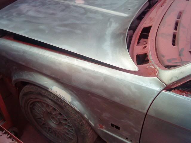

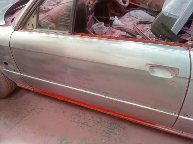

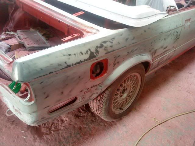

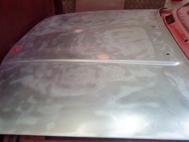

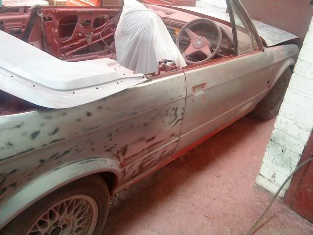

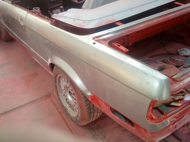

As requested more pics
spook
League two here we come !!!
Posts: 7587
Tue Apr 13, 2010 6:52 pm
How long did it take to strip that lot off.

Its an orbital air sander used on most panels but the fiddly bits round roof/boot/windows etc are all done by hand, cant afford to leave anything on the car as no idea whats been used previously, theres still lots to do but its definetly getting there lol, its took ages of hard work as there was a good few layers of paint to get through but starting to see real progress now.
Not sure exactly how long its taken as we have mechanical work booked in also which we try and clear before making a mess in the workshop again lol, everythings a lovely shade of pink though
Simons still at workshop now, hes hoping to filler a few blemishes tonight and carry on the sanding down.
If anyone wants pictures or to know anything specific please feel free to ask and were more than happy to discuss it
Anna x

That's alot of work gone into the bare metal rub down, are you doing just the outside of the panels or all the doorshuts, boot etc......... :P

Its looking like hes just shut doors/windows etc and just painted the outside so hopeful we can just key the doorshuts. The bootlid was taken off during painting so round thats being taken right down to bare metal, as it round the windscreen as were not prepared to risk our work and want a proper job this time!
Its really hard work, but trust me itll be worth it

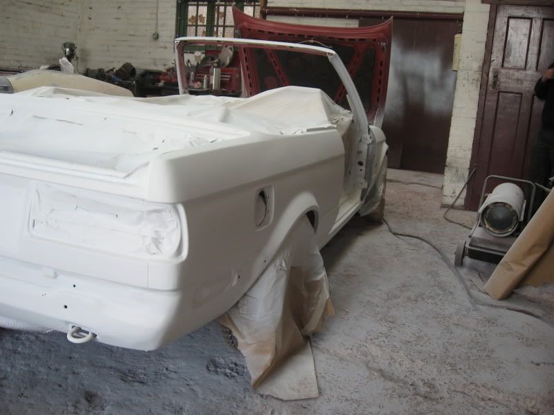

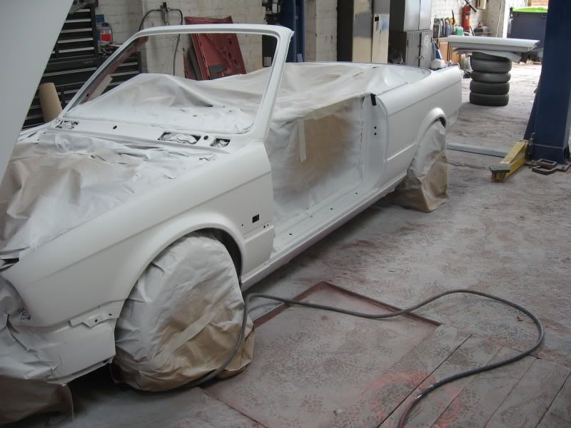

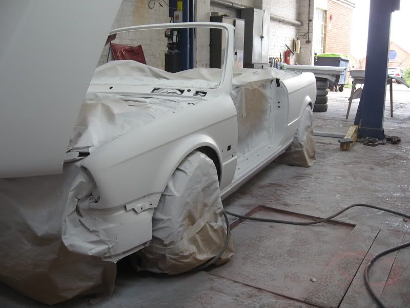

Tue May 04, 2010 2:21 pm

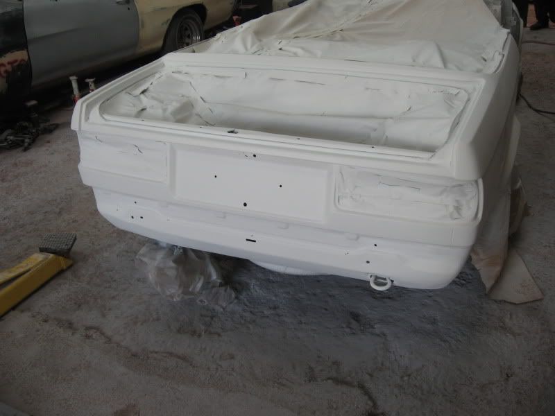

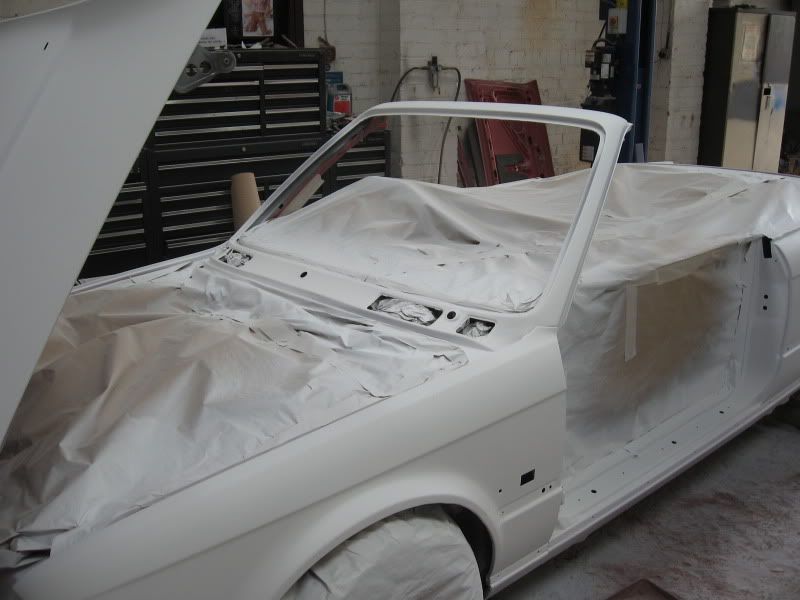

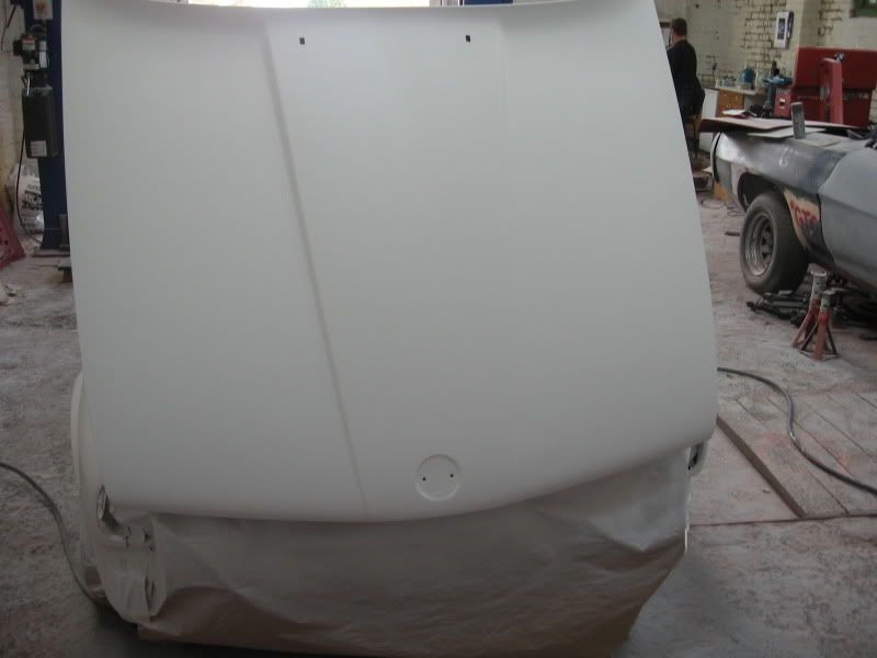

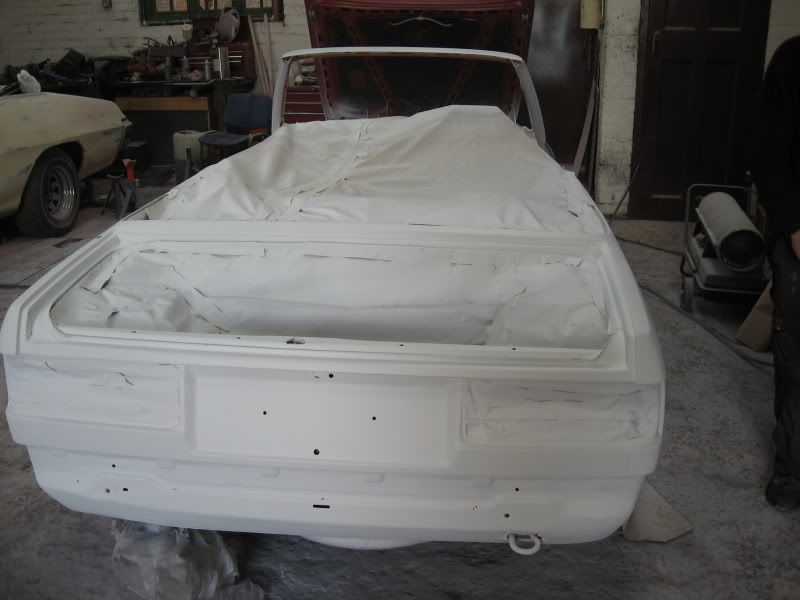

After being taken down to Bare metal, etch primed and now wearing Lingerie made
from the finest filler primer, her ladyship is now awaiting a rub down in readiness
for her base coat. All comments welcome.

Tue May 04, 2010 2:34 pm
Not sure on the colour Rob, :P
Looking a whole lot better than the previous "gent" had done.
Tue May 04, 2010 2:35 pm
Looks great
Going to look fab when done :D
Posts: 22486
Location: Derby Massive!!
Tue May 04, 2010 2:41 pm
Looking good Rob, big improvement 8)
Keeping it red?
gooner1
Out humping Reindeer
Posts: 13280
Tue May 04, 2010 2:46 pm
Yes it,s staying Red mate, this Red
