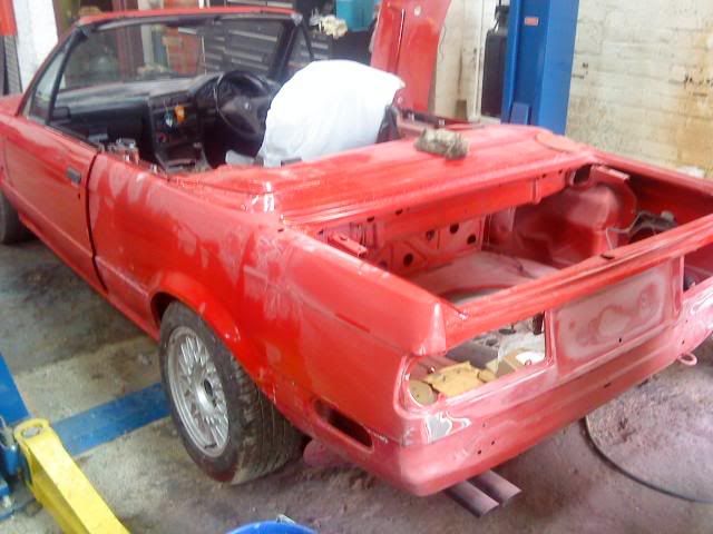

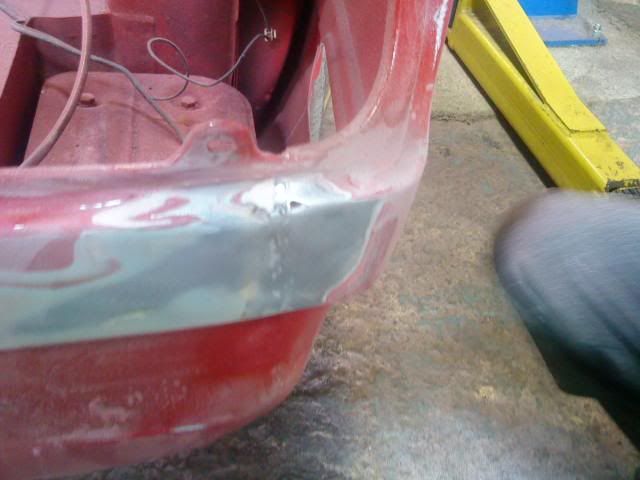

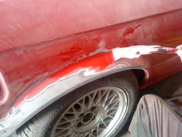

weknowtruth wrote:Well, good news is weve found the joins in the rear panel again!! Although on the o/s its been welded flat but should be fixable!
o/s rear quarter had holes in welding and was only held in place by filler at the bottom so looks like half a job there as well. The new panel hadnt been keyed either so paints just peeling off in strips round the arch! Looks like hes painted it, then re-primered it an repainted it though, also looks like different types of paint hes used.
WTF?!!! It just gets worse and worse!
What a f*cking clown! :roll:
will be uploading some photos shortly

Ah s**t. :eek: That paint on brand new panel's as well. :cry: I think I got lucky with my car looking at that.

Sat Apr 03, 2010 9:57 pm

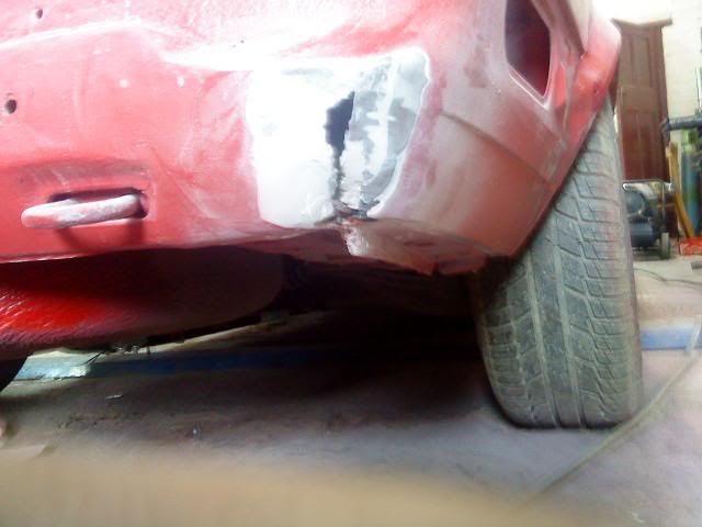

Jesus christ that was a brand new rear quarter panel was it not?!
whipsey wrote:Image

bss325i wrote:Jesus christ that was a brand new rear quarter panel was it not?!
whipsey wrote:Image
yep brand spanking new ive gotta admit i'm suprised he actually took the sticker off
Posts: 15846
Sat Apr 03, 2010 10:06 pm
whipsey wrote:Image
Problem is, he's tried to weld it to the rear valance which has gone thin. Instead of then saying "sod it, we need a rear panel or at least a repair panel the the other side of the towing eye", he's just carried on watching the panel disappear before giving up and plugging it full of shite!
And Anna's right. He's painted that panel, had reaction (or damaged it), so had to go over again, without keying up!
What a c*nt.

the primer was still wet in various places

Really sorry to here that your pride and joy has ended up like this. Weve all been had by cowboys at some point and paintshops tend to employ the cream of the crop. Please dont take this the wrong way Steve, but when i saw the initial build pictures i was worried by the car sitting on tyres, the apparent lack of a proper booth (maybe that was missing from the photos), the lack of proffesionalism displayed by the guy getting his moobs out for the camera and the fact that they didn't remove the wings to prime it. Regardless of whether or not he agreed to do it after you mentioned it, it would have been too late in my eyes. He should know better if he's experienced. How much time is needed to strip the wings off- 2 hours max...
Is that micro-blistering along panel edges too? Fcuk me that is blatantly the work of incompetence. The guy obviously doesn't know when to give up.
I know you probably don't want to answer this, but how much did this guy quote you in the first instance? I'm sure other people here would be interested for comparative reasons. I've just had mine done and it was a lot of cash but I haven't needed to worry about a thing. I also know that if ever a problem does arise, that there will be no issues in taking the car back for resolution. Id be cutting my losses if it was that fcukwit though! I just wish there was some law against imcompetent fools like this going in to business in a trade they know nothing about. The problem is you no need no formal qualifications to work in a bodyshop.
I had some hideous repairs taken out of my car. Chicken shit welding and filler around the number plate recess. Quick fix apparently according to the self proclaimed Ferrari restoration specialist based in South Wales. That's why it pays to really do your homework on these places and you really do get what you pay for.
Anyway rant over and i hope it gets sorted soon mate. Look forward to the build up pics. On the plus side, its better that the shoddy workmanship was picked up now than in 12 months time when its too late....
