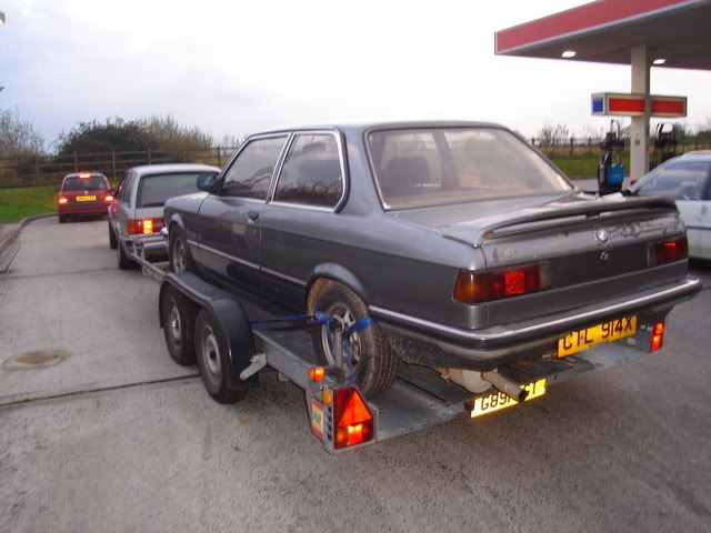

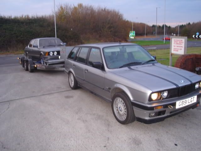

the 525 didnt hardly know it was there! does 48mpg@85 empty and 34.9mpg@70 with 02 behind
with an e30 estate and trailer it will know about it alright and will drop to around 25mpg if im lucky
