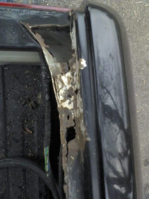

Hello everyone, I need some help with curing the rust around my boot sill,as you might see its been bodged in the past and had started to open up again,so I went at it with a screw driver and a wire brush to see the extent of the damage.
I understand I really need to sand or cut back to all good metal and then either weld some new metal back in (I cant weld) or maybe just resin and glass matting Image as im somewhat of a novice......
How much would an accident repair center charge?
Weld or fibre glass?
Anyone in the south east area fancy helping for a little dollar?

If the boots in this shape, then the rest of the car must be similar? Dont take it wrong (again) but it looks like this paticular car has come to the end of its life, theres plenty others out there with next to no rust for the price it will cost you to have boot properly repaired on its own. If the rear wheels arches and cills have rust too, then the strength of the shell will be compromised, and your safety in a shunt even worse than it already is! Break it, and put the money towards another E30, theres plenty of good ones out there.

I'd need to cut out alot! then what??
would I need to shape metal like so.....

If you are really serious about welding, then I'd ask someone like Spadge if he is breaking a saloon, and cut the same piece out of another shell thats ok in that area. And looking the pics again, I wonder if its the location of a repair-gone-rusty of the past anyway?

Supprisingly the rest of the car is tip top its an 1986 318i with 58k on the clock,an old couple owned it from new and im the 2nd ownerive had the carpet up seats out etc no rust all original undercoat in tact....so hopefully this is the worst of it...cost me £300

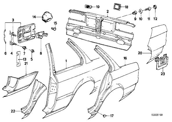

found this on realoem but not in stock.
Im thinking I might shop around a few body repair shops see what they think,think its out of my league.

That is quite a common problem on cars that have had a rear panel change. Not a difficult repair for a competent welder or get the P40 out !! :D Remember, fibreglass don't rust , so JonB says !

yeah concidering the cost of the car i think p40 and a lot of glass matting will be the way im gonna go, for now anyway. :o:

right, im going to side with pacerpete and shoot most of the doom sayers down. thats not as bad as it looks and is probly caused by the rear panel being done at somepoint or damage from putting somthing in the boot that hasnt been delt with, its hard to tell in the pictures but does it continue around onto the wing or is it just in the shut? if its just in the shut then your looking at less that 200 notes to get it sorted. certainly not worth sending an otherwise fine chromeie to the crushers for.
god if that was on a mini it would be considerd normal or a feature.

Definately not worth breaking the car for! If the rest of the car's good then keep it! I love old chromeys.
Thats no more than a £100 bit of welding maximum. You need to be prepared that when it does get welded it will probably damage the paintwork slightly

its the end of that wing thats the issue, as long as that dosent need andy thing doing to it then it should be possible to only damage the paint in the boot shut.

As the rust is not on view with the boot down so to speak the paint job does not have to be superb once welded up. Plus the paint is black so will be easy to match up with a cheap gloss black rattle can. Deffo worth fixing dude, not a reason to send it to the scrappers unless the rest of the body is fecked. Rip it apart, check inner rear arches from inside the boot and behind rear quater panel armrests cards. Check front wheel arches, take all plastic liners out and have a bloody good poke. Any rust should be obvious. Also check boot wells either side, surface under washer fluid bottle, scuttle, sunroof etc. If completely rust free its defo worth doing :cool:
Or even better you can buy a decent welder for under £100, its good practice/fun and even a novice can get the hang of it quickly. If any other rust appears later down the line (and it will) it wont cost you anything to put right.

cut out rust and clean up area , shape metal and tack it up to line it all up , weld it up, grind away welds flat , some filler work and re shape it all, then primer and paint ?
£100, good luck
if you supply a section cut from an other car, and get them to cut out infected are and welded in the new peice possibly it can be done for £100.
