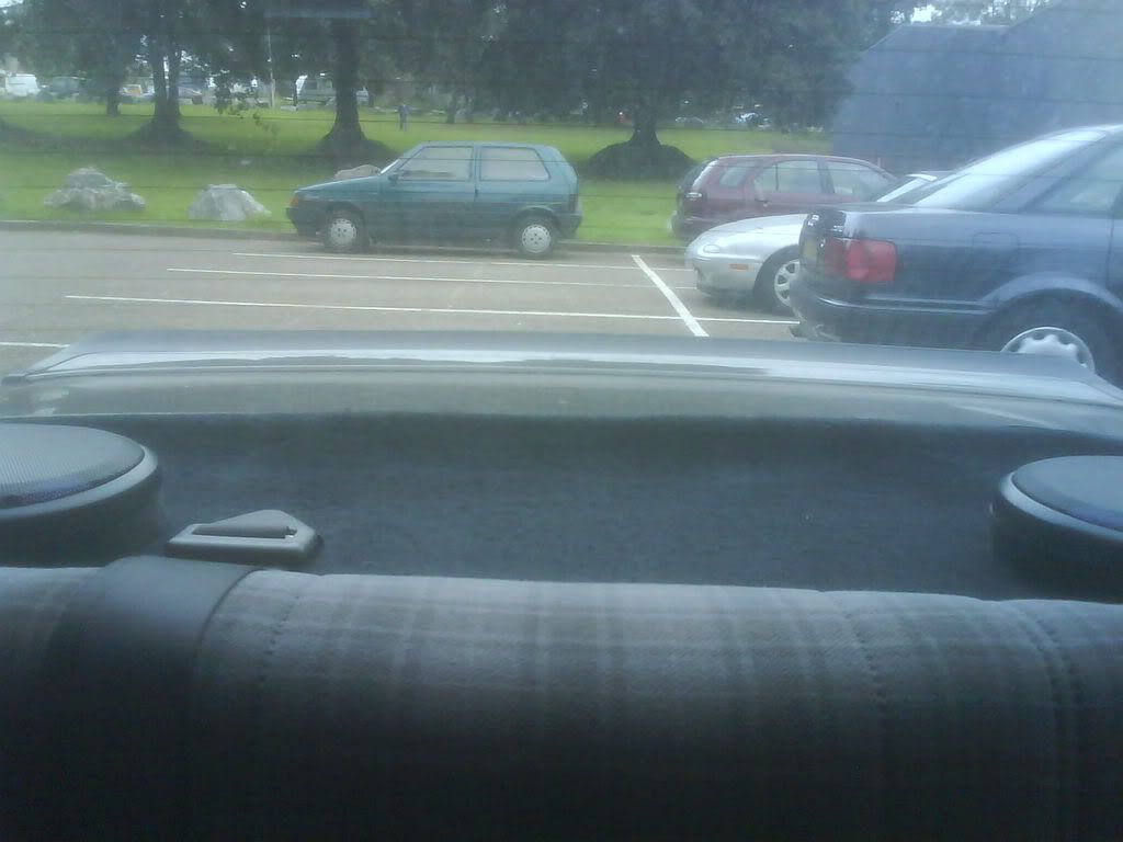

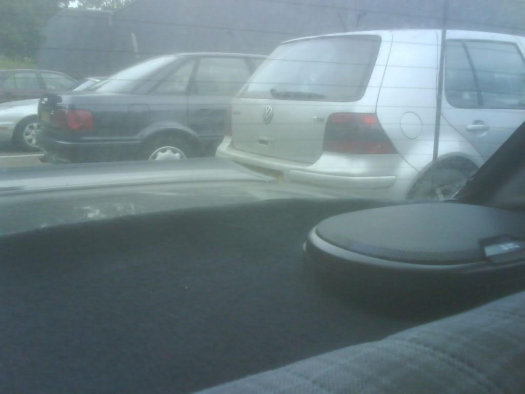

Dyed my rear parcel shelf a couple of days ago, and thought I'd share the results...
Bought 5 litres of Valeters Pride black dye off ebay. Arrived next day, which was nice :D. Also bought a trigger bottle, cos I didn't have one.
This stuff goes everywhere, and dyes anything in sight - I took my shelf out and sprayed it in the garden, but everything within a 5 meter radius is now black :D.
Anyway, i don't have a very good before shot, but here it is:
And now:
I dunno what the dye actually is, it's more like watered down paint tbh, but it does the job, and i'm well please with the results. It even stained my mdf speaker rings the same colour. :cool:
