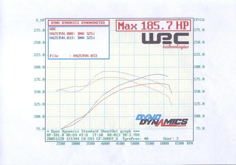

Not many people have much experience of actually modding a car and then going straight to the dyno with it. Myself and Ant have done this many times now and on most occassions havent bothered to even post up the results due to too the discussions and accusations that follow from the so many experts on this forum.
Below are dyno results - done at reputable places. Before anyone suggests that these could easily be fabricated - it is not in the interest of the dyno operator or the person testing the car as anyone can take their car elsewhere. Oz's car is a great example, dynoed @ 220bhp at Bexleys and then 225bhp on another excellent Dastek machine.
Nadeem Hejazi's 325i sport with Schrick 284/272 Cam (fitted by Ant), BTB1 and a remap gave this: (180 bhp before and 189 bhp after and a difference of 10 lb.ft)
The above is a before and after, before is with a standard 325i chip and after a remap with a MAF conversion. The engine was tired to start with to say the least! The car was afterwards fitted with a BTB2 - the result was a car which was as quick as my M3 which put down 215 bhp on the same dyno. It plastered standard 325i's. The downside was a flat power delivery under 3000 rpm.
The BTB2 manifold on a standard 325i before and after gave this:
The people who did this dyno are a serious company as are BTB. If you want us to do this test again on another proper car then we are more than happy to do it.
Oz's car has put down 220-225 bhp on the same dyno with a properly built 2.7 and all the best bolt on mods - 220bhp on that dyno is impressive when most 325i's hardly manage 165 bhp.
The BTB2 manifold is neither based on the racing dynamics nor the Hartge. The primaries on the BTB are totally different in length and bore to both. There is an X pipe.
Basically, you can modify a 325i with a manifold, cam and a remap to give a far more lively car. Good manifolds will give a PROVEN 10+ bhp in isolation and a cam will give about the same. If the car is properly remapped then you can expect even more. I know for a fact that 195 bhp is quite easily possible from a 325i.
Not being big headed here but you guys can talk all you want but we (includes Bexley Motorworks,Ant and others) have done these mods practically and have shown that these mods work and give good dyno gains. Leaving the dyno aside the cars are also measurably quicker than standard cars.

M5pilot wrote:Not many people have much experience of actually modding a car and then going straight to the dyno with it. Myself and Ant have done this many times now and on most occassions havent bothered to even post up the results due to too the discussions and accusations that follow from the so many experts on this forum.
