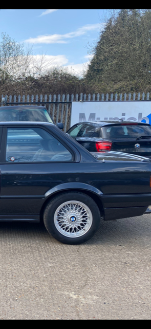

Mitchen
Posts: 2372
Thu Feb 02, 2023 12:45 pm
For those after images of how it sits.. See below. Sorry not great images and I can't get any of the wheel housing as it's in storage right now. But you can get the jist of how it sits now on standard rear springs. A little too high for my liking tbh.
