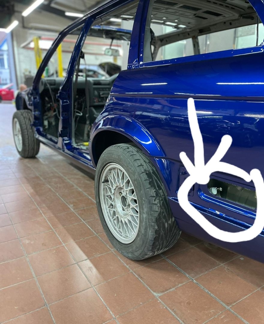

fixedwheelnut
Posts: 909
Location: South East London
Tue Jul 26, 2022 11:41 pm
Here is a photo of my touring rear quarter you can see the vent hole,
Rear vent hole behind bumper accessed from boot
