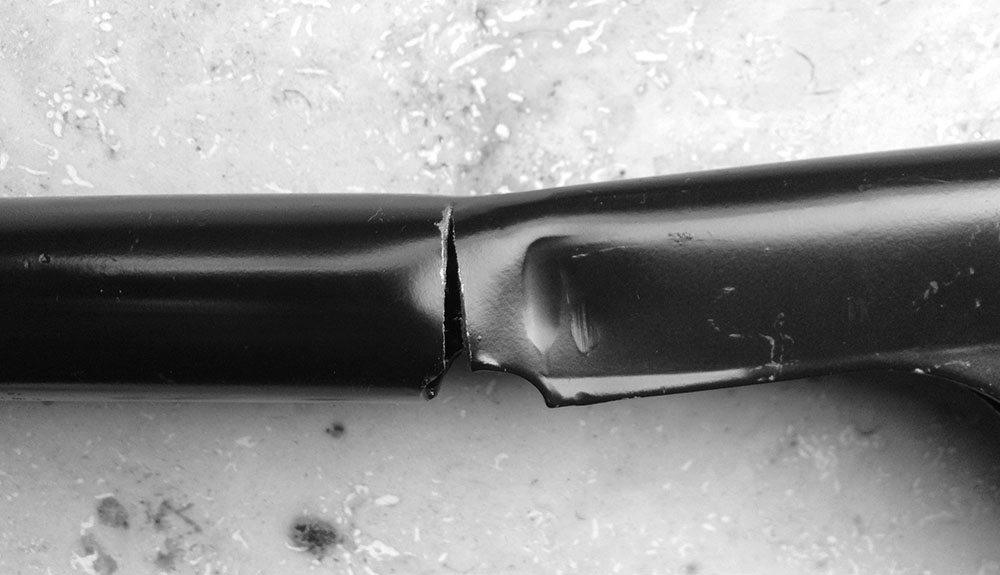

I noticed that my handbrake lever looked off center, so pulled off the covers and found it has a split half way through - never seen this before - I'm not in the habit of performing handbrake turns either.

Could have been nasty in a hill-climb or emergency situation.:eek: Good old metal fatigue, I guess...

I had the same on mine a couple of years ago. It's only thin metal and 30 years of being yanked will take it's toll eventually.

So buying a second hand one will probably result in the same failure - new is pretty pricey, but then also a major safety item.

Ive only heard of it two or three times so it could be well worth chancing a second hand one Paul.

My first E30 did that, being I was penniless at the time, I fitted a piece of tube over it, job jobbed :D

Bloomin' nightmare scenario now, getting the old cables out - found all sorts of horrendous issues with the outers, inners; no wonder the handle gave out!

This happened me during the MOT test. Failed for faulty handbrake as the button stuck up inside the sleeve. When I returned home to investigate I realised that the handbrake had broken exactly like yours Paultv. I went to a breakers and go a new one for £20. I've no idea what a new OEM one would cost. I'm sure it would get us a laugh.

They are 160 quid or so, I got one off the bay, it came this morning, looks in good shape for 15 euro's.
I did buy a new handle (plastic bit ) which looks the dogs, and a new gaiter which also looks great - very cheap from the BMW dealer here.
So I just have to replace the cables ( f'ing impossible ) then I'm back on the road!

quick update - got the handbrake lever and new plastic handle,gaiter fitted. After many days of cursing I managed to extract the sorry remains of the old cables, mostly using brute force and a small but powerful Bosch drill.
Setting up the parking brake shoes is a bit of a pig with an LSD, hard to tell when the shoes are biting as there's so much drag - no chance to simply spin the hub.
Any road up - managed a ropy handbrake turn type event on a wet hill - so it works!
