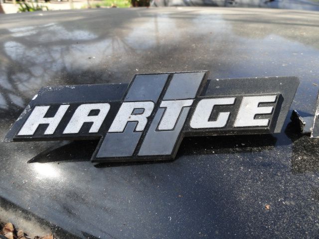

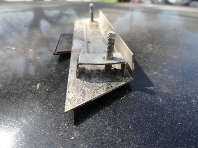

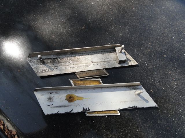

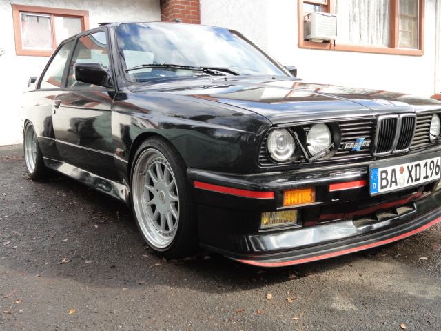

Can anyone show me a picture of how the badge sits on the grill and also how it fastens to it please?
Many thanks Mart.

I will take pics of Hartge front brackets Sunday with Hartge badge.

Sun Feb 14, 2016 3:06 pm
Brilliant mate, thanks for that.
I intend to have a small upstand along the back with tapped holes in so it can be fastened to the grill with small bolts. The badge will be of solid metal and will not bend,unless your hand fisted.

Sun Feb 14, 2016 3:25 pm
martauto wrote:Brilliant mate, thanks for that.
If you want better pics let me know. I didn't have to take the one off m car. I have new Hartge front plates that I bought years ago. I just can't find them. The front plates are made of aluminum. Alpina made their front plates of plastic.
You can email me for more pics.
Raul

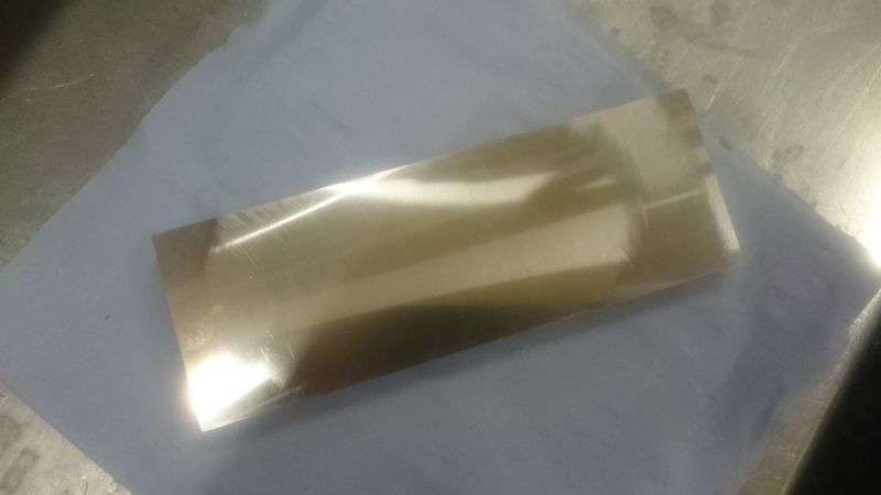

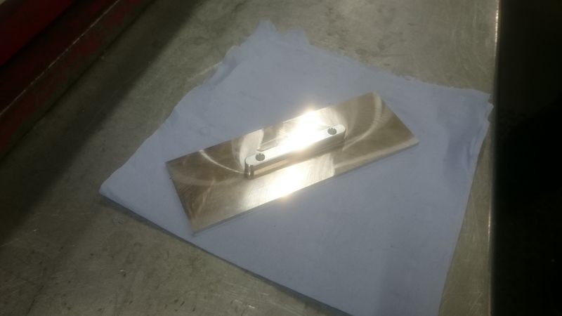

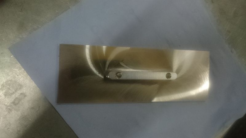

I`ve made two blanks which show the fastening detail which is behind the badge and will have two 6mm tapped holes into which the badge can be fastened to the front grille with a plate at the rear of the grille . This makes it secure and virtually out of sight.
All programing is now done and I am ready to go ....I just need a slot .....or .....should I bribe them???

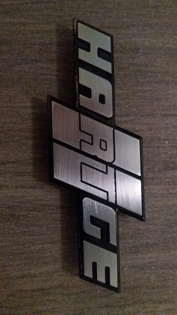

This is a first off .
I can make this better but I need your comment`s and also your commitment too.
Hope you like it !!

Hi Can some one rotate this please ?

Maybe this is more helpful

That looks very good indeed! I can load a pic of an original badge tmrw for comparison!
I think the "R" and "T" over the stripes need a little work but as it stands it look superb!
Good work so far!
Thanks for organising this!!!

can i just add that this is amazing work!! i have ben watching with interest although i do not own a hartge, i know how hard these things are...i wish i had your resources!
i don't know if it just how it is made, but if it helps,
the gaps in the H are squarer in the original on both sides.
the corners of the left side of the "hole" of the A should be square and the same with the E
perhaps Raul can answer if the cutout on the right side of the R should have paint behind it. it does not seem so from his photo but would be good to confirm
to be honest, if this was away from an original, then there would be no issue as it is so close. to get to this stage is stunning already!!! well done mate :D :clap: :clap:

Looks very good so far.

Hi and thank you for the kind and very useful comments.
Having read and understood what has been said, I can put it down to one very small culprit !!!
It is the 1mm diameter cutter that started to finish the profile which gave up the ghost and I basically ran out of time .You will not notice a 0.5mm radius in the corners.
I needed to show you something this weekend so you could decide if you wanted to order one so I can sort a price out with the owners at work.
I sorted most of the machining program out on Friday so I know both the front and back programs work well and I will speak to the lovely Claudia and develop it a touch more.
A few people have asked me what I actually do ....well I work with a small team ,@30 guy`s who are precision engineers but mainly concentrate in "bespoke " medical instruments. So be kind to me :eek:
These badges are very very strong but will come without paint as I don't know enough about painting to make the coting last long enough.
Any more comments are more than welcome guy`s, and as of next week, I will start a new thread with a price delivered (uk) but I will also ship around the world without a problem but it may cost a touch more.
