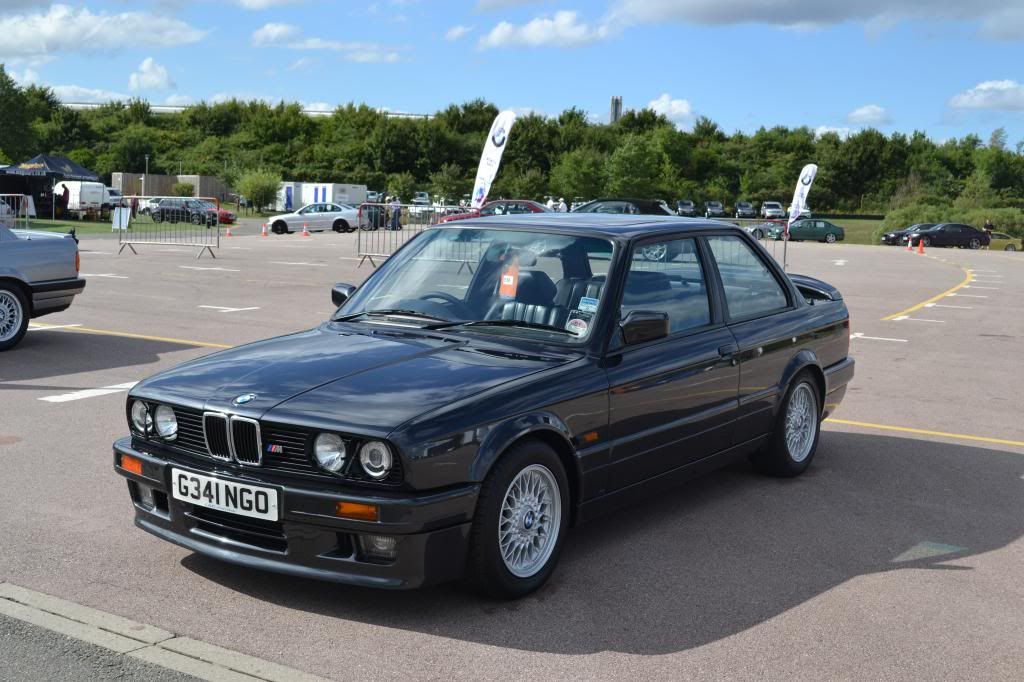

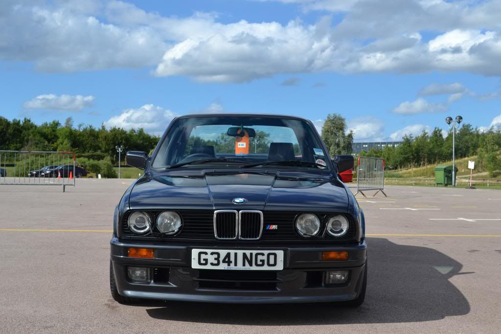

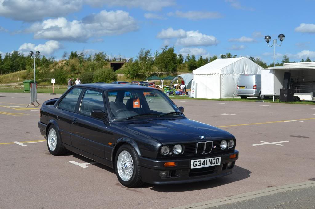

Wed Oct 21, 2015 6:55 pm
What min looks like on eibach pro kit and bilstein B8's. No rubbing at all!

bss325i wrote:What min looks like on eibach pro kit and bilstein B8's. No rubbing at all!
That is perfect cant wait to get the black sport finished now
