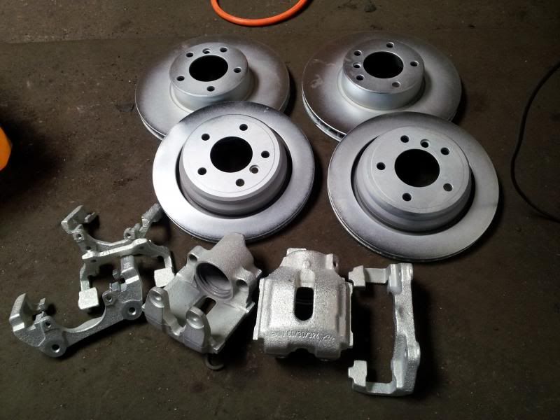

I did the Electrolysis for the carrier. Absolutely bloody amazing. They're as good as new. I'm gonna be stripping the subframe back to replace all the bushes. I'm going to probably Electrolysis for everything rusty. I'll post some pictures soon.

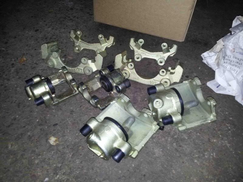

I've recently finished mine, got these off a car which had been stood up for 5 years.
new bleed nipples, seal kits +dust boots, rear spring clips and Three coats of High temperature paint.
All in all the calliper bodies cost about £85 to do all four, not including pads and hoses.
They aren't that bad of a job if you take your time
