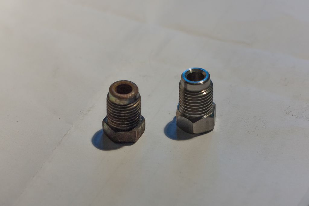

Jozi
Posts: 3076
Location: Dublin, Ireland
Wed Feb 12, 2014 12:39 pm
Their just stainless brake pipe nuts, I couldn't find (didn't try) stainless pipe :p
I've spoken to the guy I got them of, should be able to send them back and get the correct ones made.
Thats what I've got.
Motorhole
Posts: 2395
Location: Cheshire
Wed Feb 12, 2014 3:21 pm
Yeah they're for female double flares. You need metric (M10) male fittings with flat shoulders, like these:
http://s1097.photobucket.com/user/wlwlt ... 1337698518
You need the stubby ones like the ones in the pic too. The longer ones won't allow the pipe spring-clip (where hardling meets flexi line) to provide any tension :)

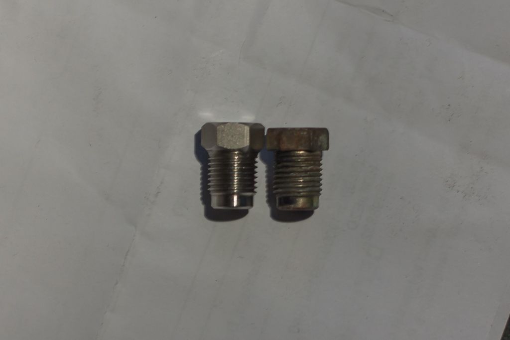

Jozi
Posts: 3076
Wed Feb 12, 2014 5:14 pm
Here's a brake nut I cut from where the abs pump used to be, I'm going with the assumption that it's original? It's roughly 16mm overall
Motorhole
Posts: 2395
Location: Cheshire
Thu Feb 13, 2014 12:04 pm
Yep - the original should be M10 x 1, metric male. These are what you want, but you may be able to get a bulk pack from a reputable ebay seller if that's what you want:
