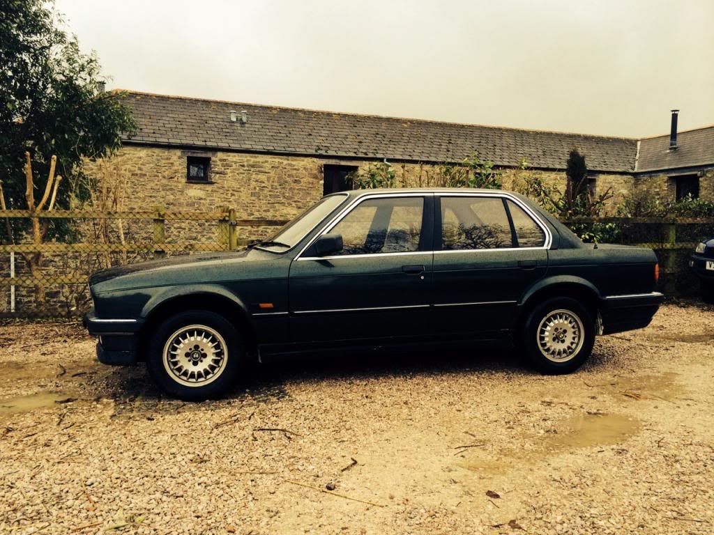

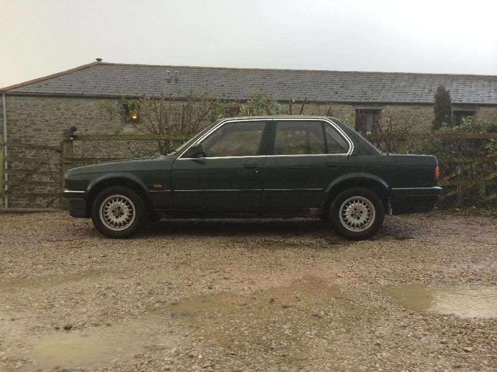

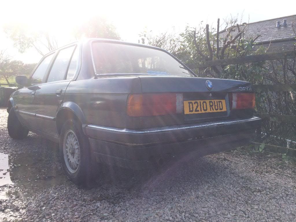

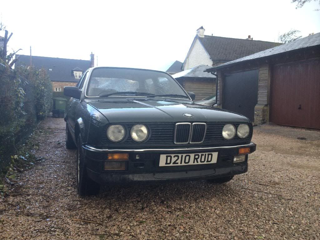

btw for those interested, how she sits at the moment.
Posts: 11155
Wed Feb 12, 2014 5:45 pm
This is lowered on H&R 35/40mm springs.

Thats a lovely height thank you for that pic! Not tempted by 40-60?
What size are those wheels please?
Morat
Posts: 8943
Wed Feb 12, 2014 8:38 pm
You'd want 60/40 F/R unless you like the reverse rake "speedboat" look.
At 60 mm your sump starts to be in real danger on an m20, and it's worse for an m50.
A sump guard is possible of course....
15" wheels never really fill the arches on an E30 unless you run a really ridiculous drop, especially if you run skinny tyres. The eibach pro springs and stock tyres are a good compromise for looks and handling. The only downside is the negative camber which you can only get rid of with custom camber plates and a bit of welding but at 35mm it's not too bad.
If you have the cash, go for the full B12 spring/shock combo and add the matching eibach rollbars.
Enjoy :)

Mechagran wrote:btw for those interested, how she sits at the moment.
All that needs is a set of decent springs. I would swap to 51mm struts as well because the original 45mm struts are limited on damper choice.

So, picked up Rudi a few weeks ago. Spent about £100 to get her through the MOT (4 feb) - mainly ball joint and a few other bits nothing too major (phew,). Always wanted an e30 and because this is going to be "the ultimate sleeper project" I wanted something fairly innocuous; a four door mala green 320i with jade upholstery seemed perfect.
Here are a few of her as she sits now

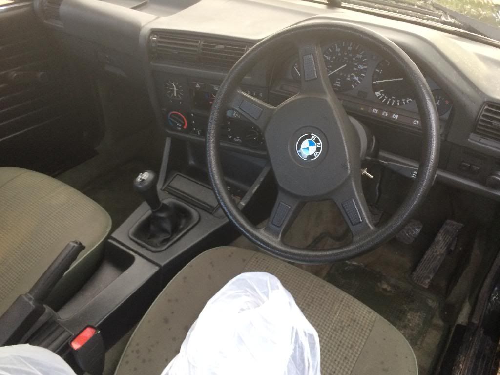

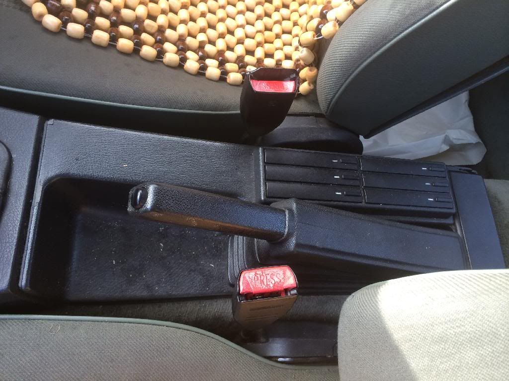

As far as the interior goes, it's a light pine green one (nicer than it sounds!) but I could not resist the retro beaded seat covers! Looks great IMO... :cool:

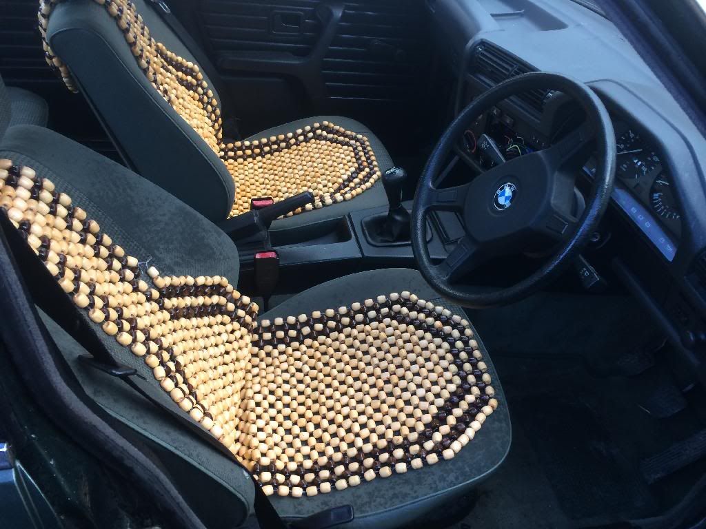

Tape holders! It's even got one of those weird little mini dash board tester thingies by the rear view mirror so you can see what bulb / light isn't working with a "test" button!
