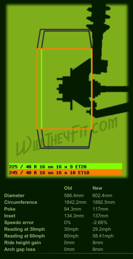

Theres nothing wrong with 10j wheels...
So long you don't say it's stanced its fine....
10j is prob a bit of a squeese with 9j ET20 there is about 5mm clearance to the shock. So go on willtheyfit.com
The will prob poke out like 23mm if you have an offset of 10?
I dunno have a play its a useful website....

That looks very useful Minimayhem! I (somehow) forgot, I also modified the shock towers to get shock clearance. :mad:
