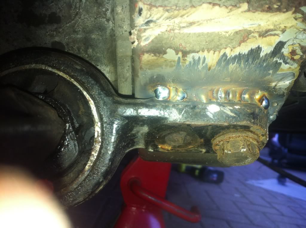

wow... did you prep the lollypop at all??? was the earth clamp attached to a tyre?
not being funny but that is rubbish.. take the other bolt out and wallop it with a hammer, if it falls off then it's not suitable.. this is a stress load point of your suspension.. if this goes you are f*cked.. you want to gamble your life on this then so be it.. but don't say we didn't warn you!

rhubarb wrote:
ross_jsy wrote:You welded the lollipop on?
Classay turd you have there sir! What happened to welding a bolt to the end? At least the welds look tidy!
tidy weld? specsavers mate..the weld is penetrating the chassis and nowt else, and round the side is a series of tacks 8O
I said tidy, not good!
Whip the diff bung out and splurge some weld in there too by any chance?

turn it in an i have wacked it it dont come off and the lolly pop in concaved where it joins it seems perfecly fine in hammer test even with bolt out i am going to run ove it againfor safety sake and yes i welded a nut on and it sanpped again
Tom_Maverick
Posts: 1343
Location: Brighton
Fri Feb 03, 2012 3:46 pm
BATTS91 wrote:yes I welded a nut on and it snapped again
bodes well for the lollypop weld! maybe, for safety's sake, get a qualified mechanic to have a quick gander at it before you take it out for a shakedown..

who is going to want to get involved?..I'm a mechanic, been in this trade nearly 20 years..That repair is a total joke..

Not being an 'expert' welder,but that bracket looks like a casting to me,do you not need a 'spchul' method to weld a casting to steel?

all joking aside, I am advising you not to drive the car until you've had that weld looked at by a professional.. it's all very well having a crack at it yourself but you are not a mechanic and have very little mechanical knowledge so play it safe.. the last thing you want to do is end up in hospital or worse..

the bush is the same other side mate and this is better ?Image

BATTS91 wrote:the bush is the same other side mate and this is better ?Image
that does look better, it's not a bad looking weld by all accounts.. I'd still get someone to look at it..
Fri Feb 03, 2012 4:12 pm
That CA bush looks fooked.. Think you need to replace it!
With the full weight of the car on it first bump you hit at speed will knacker that :eek:
BMW put two bloody thick bolts through it rather than tack-welding it in place for a reason.
The only place you should be driving this is very slowly to someone who can repair it properly.
Agree with demlot - much as this is providing comedy value I don't want to see a zoner getting injured and writing off another E30 through this sort of bodge-fest. :cry:

well if a hammer can hit it off im not happy so having a smoke n gonna wack this i grinded it all off for that weld and ill be honest the first was totally sh!t so ive got more power and better penetration on this time we shall see i dont understand the problem someone else here mentioned welding theirs on and hasnt got abused ? !
Without seeing the penetration it's hard to tell, welds can look great but be holding nothing. For something as critical as that I'd be mocking up a test weld and nick-break testing it.
Usually for T welds I'd be putting another 3 overlapping lines over it.
