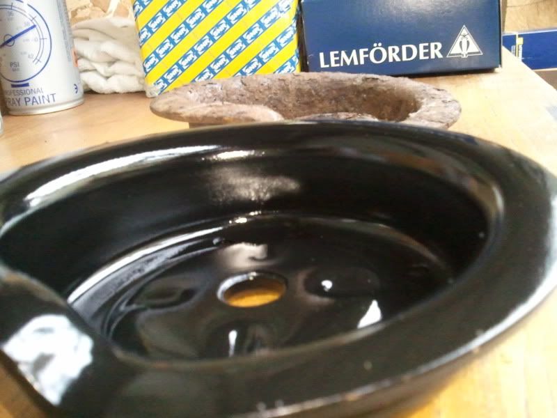

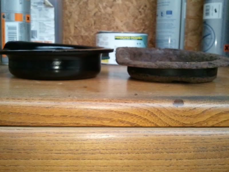

Got my new top hats today and painted them up, took a pair of struts apart today as well to give an idea of the difference between the E90 and E30 tophats.
Hard to tell the actual height difference but it is clear to see the top mount will sit quite a bit lower.

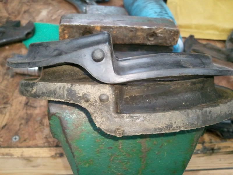

Here's the difference in springs pads to.
I reckon you're looking at something around a 15mm drop on the front using these for little more than £20

The top mount will remain in the same place but the top of the spring will sit higher up in the wheel arch hence the car being lower.Kedge wrote:Hard to tell the actual height difference but it is clear to see the top mount will sit quite a bit lower.

Yea that's more like it, my explanation was a bit on the shit sidebss325i wrote:The top mount will remain in the same place but the top of the spring will sit higher up in the wheel arch hence the car being lower.Kedge wrote:Hard to tell the actual height difference but it is clear to see the top mount will sit quite a bit lower.

Only one concern, looking at that picture the are considerably thinner than the 10mm (obviously), will these wear/perish quicker??
