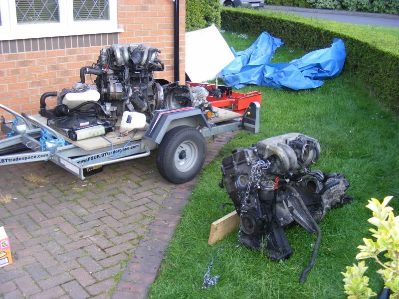

A huge thank you to Boyd Beattie cecotto479 for all his hard work and excellent communication throughout the saga that has been my m42 repair.
Some secreted previous bodging and an over engineered exhaust has made Boyd's life difficult for the last wee while but I am absolutley delighted to report my turd will be ready for collection tomorrow A.M.
There isnt a big enough Emoticon for my excitement
I will update how its driving and se if I can get some pic's up over the next few days!
I'd also like to say I've read through his negative feedback and can say that NONE of it chimes with me. AT ALL.
P.S I dont fancy him or anything before I get 'ripped' for the praise.

I dont have the ability to explain (I have zero mechanical comprehension) it other than stuff that really shouldnt have been there was.
And the Exhaust was a good job but it made it really difficult to change the engine 'apparently' :)
The origional issue with the car that caused the problem was a simple bit of plastic that caused the drive chain to jump and it foooked 4 cylanders and rods (does that sound like im using the right terms lol it was a few weeks ago I was told)
Decided it was best to replace with a second hand engine until money is available to properly sort out with an engine conversion and uprating the brakes

It wasnt the original engine it was in it, it had an e36 m42 that was in there even though it was sold with loads of history....... relating to an engine that wasnt in the car lol
A coulple of things were used to fasten and secure things that werent supposed to be used, that meant they wouldnt come back off and had to be drilled out. which led to new 8mm studs in the exhaust I think thats right.

Yes same engine Ian I think Boyd was of the opion that it was an e36 m42 If he's on this I'm sure he'll correct if Im wrong.
Had the car back on the road tonight I am totally delighted!
it's sweet as a nut when giving it some beans but a bit tappy when idling in neutral. Hopefully that will settle down.
Couple subtle changes since you had it old wheel is back on new gearstick new seatbacks new ashtray cover planning on a black stereo unit.
I want to get th exhaust a bit quieter lol you're big boyracer Ian :)

It had an E36 M42 engine.
I was quite surprised because when I owned it, I recollect a huge history file and I'd have remembered a replacement engine. So we don't know what mileage the engine in it had actually done.
I didn't know until I stripped out the timing case and saw that the bottom wheel had been replaced by the plastic guide as per the E36 engine. I wondered if it had been done as part of an earlier timing chain job.
Not until I was fitting the new (E36) engine that I had it confirmed though. The spigot bush on the engine that came out was correct for the larger E36 first motion shaft and not the 3mm narrower E30 one. The first motion shaft had been whirring away in space unsupported by any spigot bush.
Eh? :?

The spigot bearing that supports the gearbox input shaft was the e36 sized one for the e36M42 Getrag 250 gearbox. The e30 M40/M42 gearbox uses a smaller shaft and bearing that needs to be swapped over/replaced if you are using an e36 engine. If the old engine had a larger spigot bearing then it was more than likely fitted to an e36 originally.

That's right. The engine that came out was obviously an E36 one because it had the E36 spigot bush in it - doing nothing.
