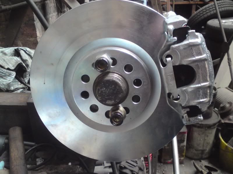

Paint is a waste of time, ive tried it and it just burns off if you use the car properly, perfect for the concourse bufties that trailer their cars everywhere :)
Rusty discs are nasty though especially if you have great big fook off ones behind the wheels, when I did my brake upgrade I had the discs zinc plated and its worked very well, the zinc soon came off the friction area and keeps everywhere else nice and silver 8)
Emm3
Posts: 866
Joined: Sat Apr 08, 2006 11:00 pm
Tue Jan 10, 2012 11:35 pm
DanThe wrote:Paint is a waste of time, ive tried it and it just burns off if you use the car properly, perfect for the concourse bufties that trailer their cars everywhere :)
How much did it cost to zinc plate?
Posts: 28640
Tue Jan 10, 2012 11:45 pm
Emm3 wrote: How much did it cost to zinc plate?
Depends how much you take to have done at the same time, but generally about a tenner a disc
