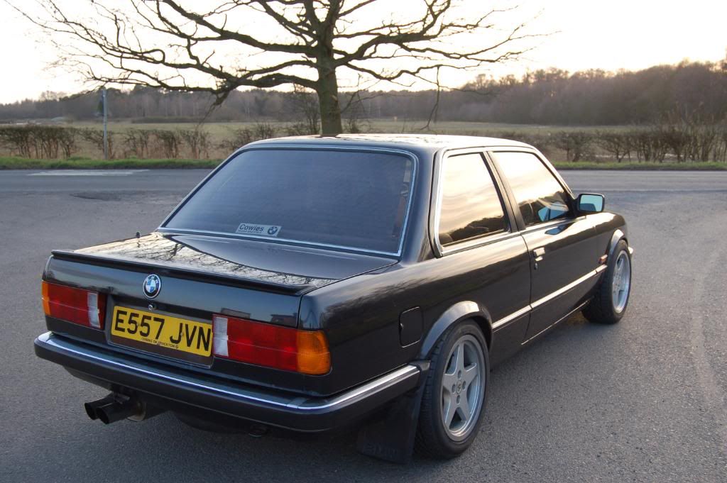

I reckon you'll rub with 20mm spacers on 17's, maybe 15mm more adviseable.
This is mine with 16" x 7.5" ET38 without a spacer. (bear in mind mine is a chromie so has higher rear arches) Car is on a -55mm drop front & rear in these pics
This is with 20mm spacers, so taking it to ET18
