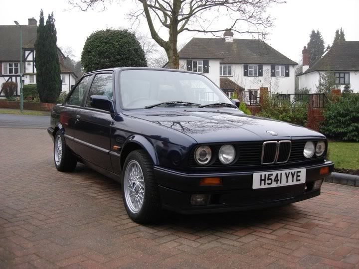

Should I lower my iS?
senna
Posts: 612
Sun Jun 19, 2011 12:48 pm
The handling is perfect on original springs and new Bilstein shocks.
I would just like the front a bit lower, without harshness etc.
Springs or strut caps?
What softish springs would you advise?

not sure what its like where you stay but i struggle with speed bumps with my standard sport suspension.
Brianmoooore
Posts: 49359
Sun Jun 19, 2011 4:08 pm
snowmaan wrote:not sure what its like where you stay but i struggle with speed bumps with my standard sport suspension.
That iS doesn't look to me like it's on standard sport suspension.
Maybe it's had the wrong front springs fitted somewhere along the way over the last 20 years.
Sun Jun 19, 2011 4:50 pm
sumps are your enemy when going lower than say -35mm
standard -15mm mtech springs with 16" wheels on 45 profile tyres
and on 14" with balloon profile tyres
maybe she is lower then hard to tell as they look standard rusty brown hahaha.
Brianmoooore
Posts: 49359
Sun Jun 19, 2011 5:40 pm
I don't mean lower. It looks higher than standard 'sport.'
Sun Jun 19, 2011 5:47 pm
it looks more hi-lux than low-lux

senna
Posts: 612
Sun Jun 19, 2011 7:57 pm
I put it on 205 50 15's
The springs have blue/green dots on so I think it is just the tyre profile
DHFiS
Posts: 2733
Location: cambridge
Sun Jun 19, 2011 9:07 pm
Mine measures 625mm from the road to the top of the arch at the front and 590mm at the rear.
The tyres are 205/55/15
senna
Posts: 612
Sun Jun 19, 2011 9:30 pm
DHFiS wrote:Mine measures 625mm from the road to the top of the arch at the front and 590mm at the rear.
Thank you!
61.5 cm front
58cm back.
I may lower it by 10 mm at the front and leave the back.
