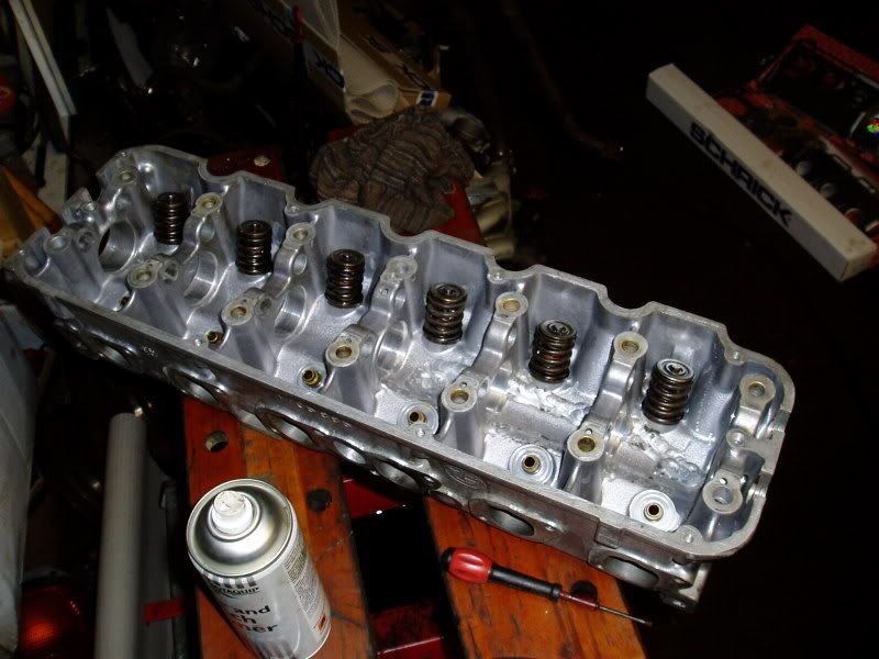

Check the weld. Lets lay it to rest, i was of the opinion that welded heads were sh!t and to be avoided. Add to the mix a trick worked Alpina head and you consider the options more wisely. As they were £3000 odd new. Of all the people with C2 2.7s i met ALL have cracked the head at some point usually 100,000 to 130,000 miles.
Any how this Alpina head from the touring wagon was over hauled by FAB back in 2000 after over heating problems. Boxer motorworks performed the rebuild to a very good standard i'd say. Head has been welded 10 years now and covered 50,000 miles since and 30 laps of the ring for good measure. The engine is a peach and theres no fear of beasting it and it sh!tting itself! Of all the M20's i've had this one is my favourite by some way.
nowt wrong with a welded head in the right way.

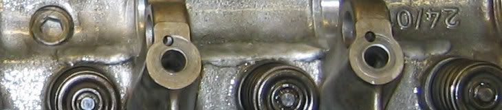

Heres a shot of my old head that was welded. It had no issues and as far as I know is still running. Some say they are stronger once welded (if done properly).
