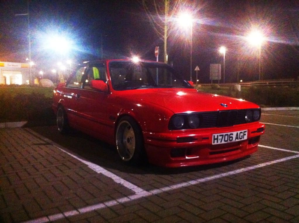

Ive got a 3mm spacer (you can't get these hubcentric as they are so small) and mine clear the caliper by a couple of mm and i have a 60/40 drop on springs and shocks.
My tyres are 215/40/16 and sit perfect but may got 205/40 next time.
Hope this helps.

Loving the red tech2 on borbets, I would take the insulation tape off, it will look alot cleaner winkeye
