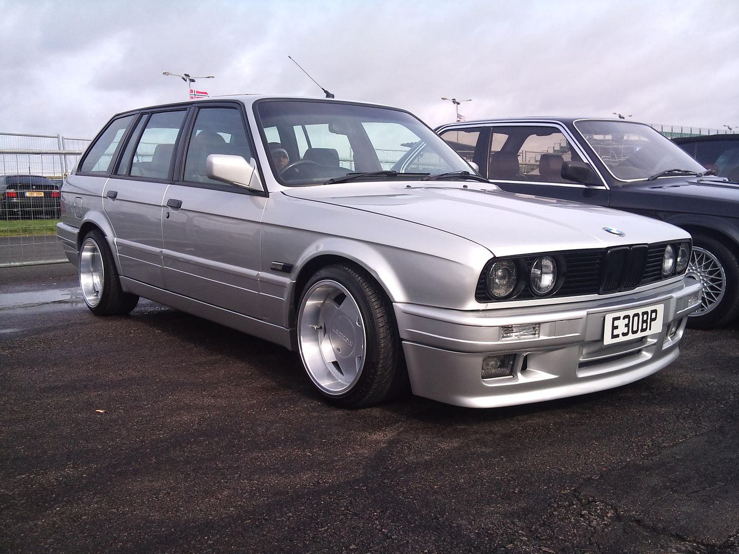

Jozi dude i have 205/40/16 on 9j all round no problems at all fella
3mm spacer on the fronts, stering is fine. Had a really smooth
Ride to pod at the weekend.

Never knew you had 9's Baz, not until the post above. She's looking very nice!
Coincidently, another Baz got me thinking about keeping the 9's. He's also running 9J Borbet B's all round. I'll just have to shove them under her before taking her of the road to see what it's like.

had all the work done on my touring last week fella no one had seen it untill it went to pod
have some really good feedback on it, couple of guys wanted to buy it, it will be fine dude get some and stop fannying about...... winkeye
how low is your touring jozi ? i`m on coilovers and i`v had it slammed and they still dont catch very nasty ride that low tho.
