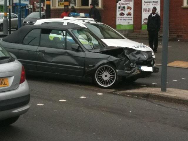

Hello i was envoled in a accident in my 89 325i cabby. Someone pulled out on me
The insurance took the vehicle to a bmw repair centre and they have come back with a estimate of £9,500 :eek: and has been declared a total loss
The car is damaged from the front, mostly on the drivers side. The car will need to be jigged and the wheels are out of alignment :(. Also the suspension turret is now touching the battery.
I really want to buy the car back, because its been in the family for a long time, and it has all its m.o.ts and a stack of reciptes. It also has mint leather and a new roof. I have also had a tech 2 kit fitted to it
My question is can i buy a cheap 325i touring,coupe or moredoor, that needs alot of mechanical work, and use all the front end panels (lights,grills,suspension parts etc) to rebuild my car?
Thank you

I have not spoken to my insurance company yet so dont no what cat it is. But the body repair man at bmw did say it was fixable.
Will a touring/saloon bonnet and front upper and lower panel panel fit?
Only pic i have:

evry-thing will fit apart from the wings,
shxt that looks bad 8O

Based on that pic, the chassis will be totally bent, which has probably affected most of the items in the front/through the car. Bar the roof/rear & interior, I doubt there's much saveable, never mind ever re-using parts to rebuild.
I'd be looking at a cash in, buy back, strip and sell. Add that to the money from the insurance claim, and I bet you'll be able to buy just as good an example, and you can start the family car ball rolling again.
Any other option is likely to leave you seriously out of pocket both short term and long terms
