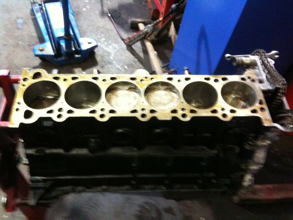

M50 bored out to 86mm (S50)
Just to show wall thinkness. Standard M50 is 84mm.

Yep, compared to the S50:

Interesting M50 block must be longer than S50 then? There is 5mm in between bores on my M50. That's with S50 pistons.

fark that will be why people don't seem to run crazy boost through them!

How does that work then fella, considering both have the same sump fitment :P

dezzy bores must be laid out in a large arc! 8O :D

I new that too. I am thick.
Why do the S50 bores look much closer together?

hmmm are you sure they're s50 pistons, since the s50 engine has a longer stroke than the m50 to get it's capacity to 3.0/3.2 which would mean you're compression would be something like 7:1 with M50 75mm stroke vs B30 85.8mm/B32 91mm? also the above pic is a B32 which has a slightly bigger 86.4mm bore.
Tue Mar 30, 2010 12:11 pm
How does that work? He's fitted S50 pistons into an M50 block with a 2.8 crank, the compression ratio will be fine..

M50/M52 share pistons and rods. S50 pistons are the same height as M50/52.
I have used M50 block, S50 pistons, M52 crank and rods. I also have taken 0.5mm off the block for a comp ratio of 11.1 :cool:

I didn't know he has used a 2.8 crank, assumption is the mother of all fuck ups :)
Dezzy wrote:M50/M52 share pistons and rods. S50 pistons are the same height as M50/52.
I was talking stroke (piston/rod/crank), thought you had kept the M50 crank with stock rods and S50 pistons.

^^^^ So was I.

the pistons / rods make no difference at all to the stroke, only where the piston sits in the bore / compression ratio.
keeping everything else equal but fitting a longer stroke crank the piston would be sat higher in the block at tdc as the crank has pushed it up further, youd need to use shorter rods, or pistons to bring it back down to the same compression ratio.
