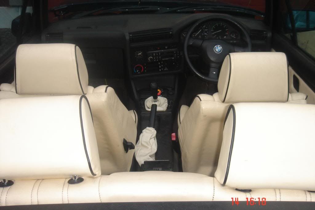

The car is at Sweeps at the moment, just getting the brakes and engine checked out with a few other bits. Loads of work needs doing to it. Should hopefully get it back this weekend and can make a start. Will post more pics soon. For now, here is what the interior looks like:
What do you think.

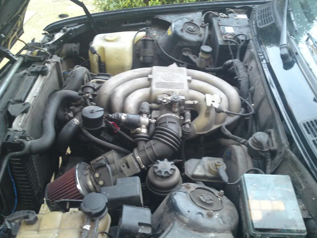

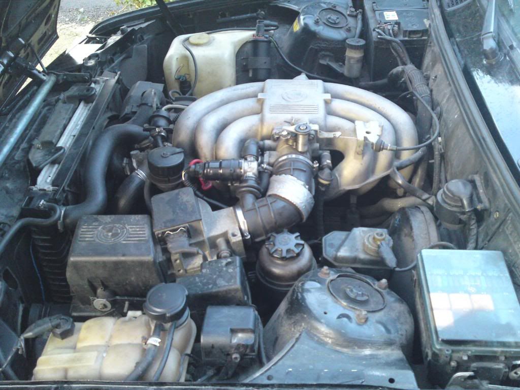

A few more pics of my engine:
before
and after
Engine seems to be running fine but the battery is getting drained. Ive dropped her off to the electricians to have all the electrics sorted.

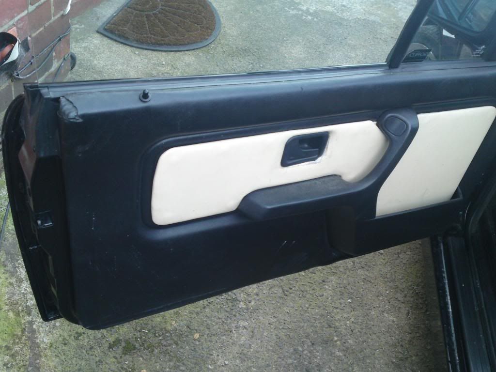

Whilst it is there, might start on the interior. The door cards are the worst:
Can someone quickly advise how to remove the door cards. Dont wana break anything.

Door cards - 3 screws in the arm rest (remove blanking plug and mirror switch) then pop off (and burst the majority of the plugs in the process and lift the card up.
Back cards - screws obvious after you remove the inner panel (pops off) - similar principle im pull out (remove seat base first)
You will also need to undo and thread your seatbelts
through the rear doorcard, watch the springs on the seatbelt
anchors.
