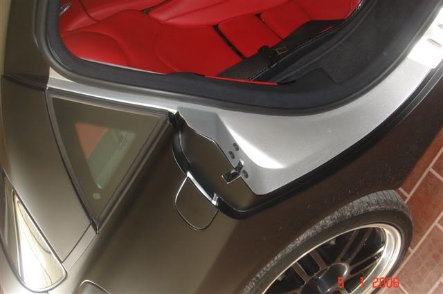

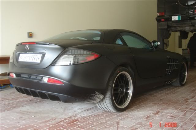

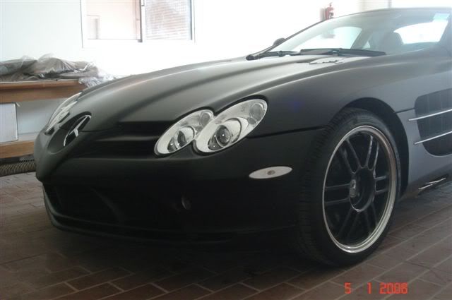

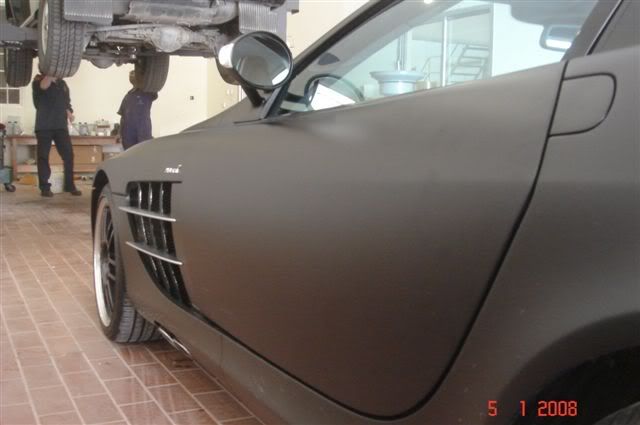

i have seen this done myself and it is not an easy task!! It is quite a skilled job which does not take much in the way of special tools, but does require a skilled person to apply it properly and with out creases, much in the same way tinting is easy if you know how, but (normally) ends up a real mess for DIYers. I can best equate it to those lads who remove dents without painting...if you watch them it appears quite easy...if you try it on a dented Spanish hire car its really really hard and it looks worse :o:
This cheapo car belongs to a local youngster and was (or really still is) Silver he wanted to buy a 722 with pocket change so before he decided on the colour he had is bog standard SLR wrapped in matt black. apart from the mirrors (which were sent back - but to be honest they are a very compicated shape) you could not tell from more than a metre away, and of course as you opened the doors. stone chips are easy as each panel is covered, so simply replace a panel (it also more resisitant then paint anyway!) each panel is normally pre cut from a template so simply cut out a bonnet panel and apply it to the car
As for rust that is a HUGE no no. rust must be removed before applying the foil, otherwise the oxidisation process will happily continue under the foil and you wil have flappy foil (as the metal under the foil disappears!)
would i do it to my car....yes but only if the paint was in good condition before i cover it. would i do it to a turd...yes as its probably cheaper then painting. have i dont it...No.
enjoy...
