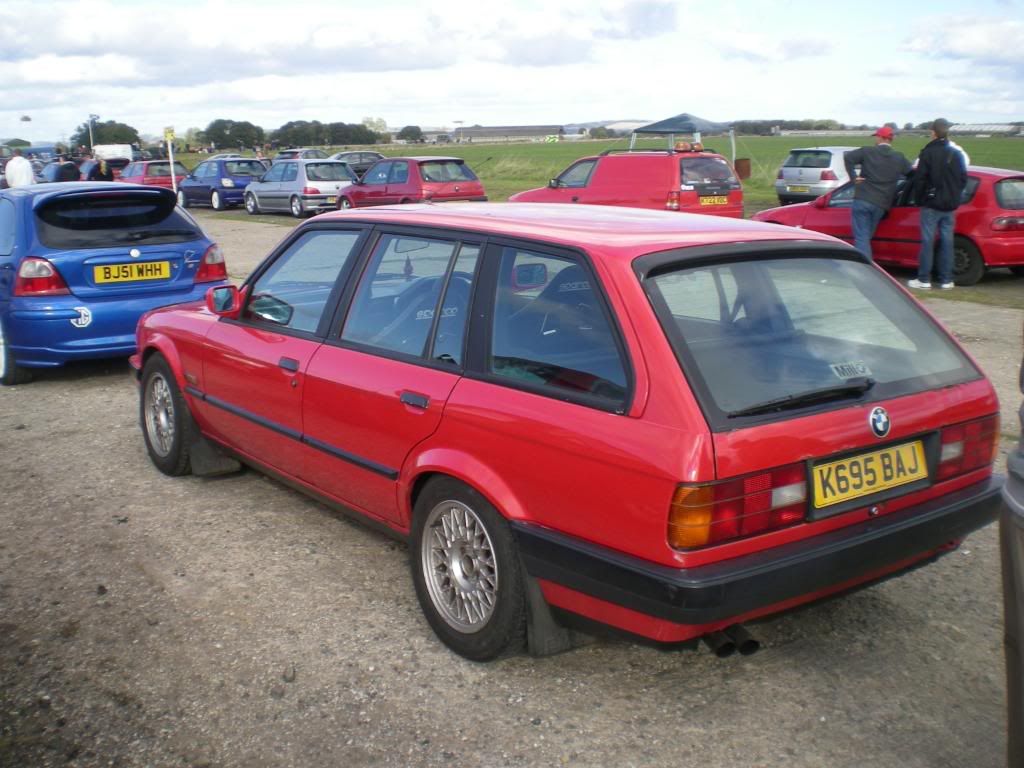

I have the 60/40 kit on my touring. It is quite firm, can be a little crashy on sh1te roads but its better than the H&R cupkit, which I had on my iS.

I have Weitec 40/40 kit on my touring, with decent dampers and I was impressed with the ride, but I was running 60 profile tyres which made it a bit squidgy so I could never truly tell how good it was.

I have driven Benjys car, which I think is a nice firm ride and corners very well, which is why I ended up going for my -60/+15 kit :!: :snigger:
