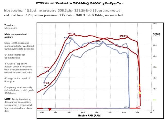

Interesting thread, I'm looking into force induction. Claims on the internet suggest that the internals on the m20b25 can withstand circa 400 brake, the only thing changed were the rods for b20 items. The pistons were the later, lower compression type.
High revs seem to be the killer, as long as you limit the revs to 6800rpm you can achieve high bhp, reliably.
