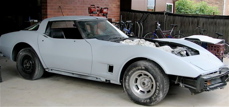

This is my mates Corvette im building, I have put around 120 hours alone in the bonnet and probabaly more then 300 hours on the body, and the car still isnt ready for paint. The car is fibreglass and was as ripply as a boat. "WAS". It is now 100% gun barrel strait. This shows just how difficult and time consuming it can be. However I am a perfectionist and the car is a custom job and I am building it to show off my skills so people know what im capable of.
If its to good to be true it ususally is. Paint is the same.
Mike
